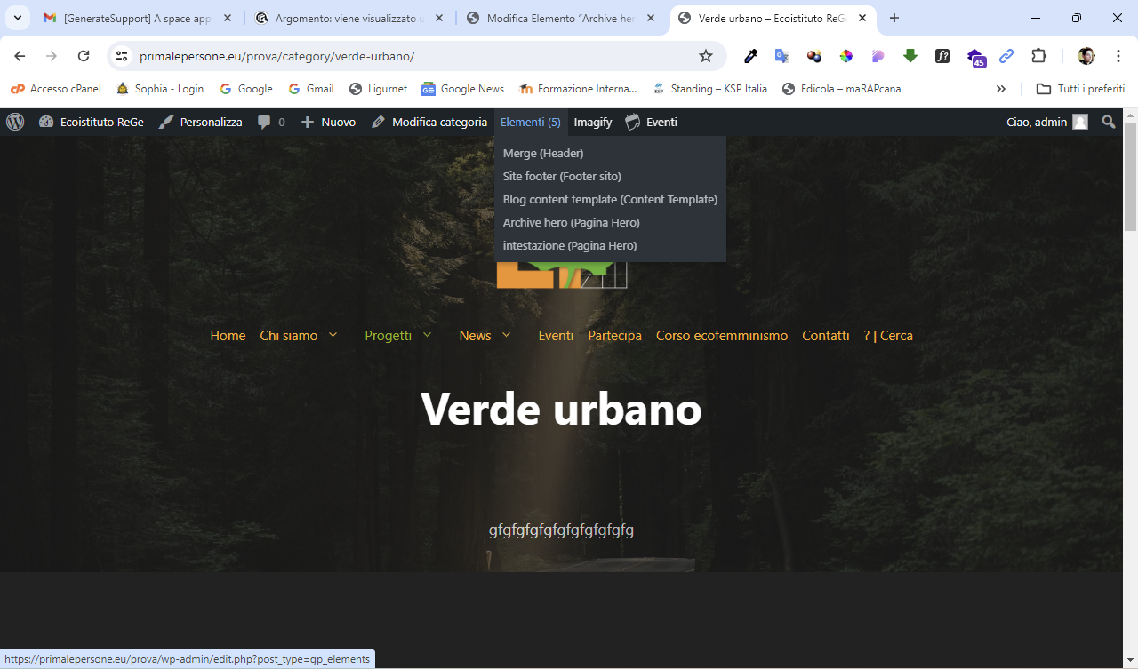

On this page, hover the Elements menu in the top admin bar, what elements do you see?

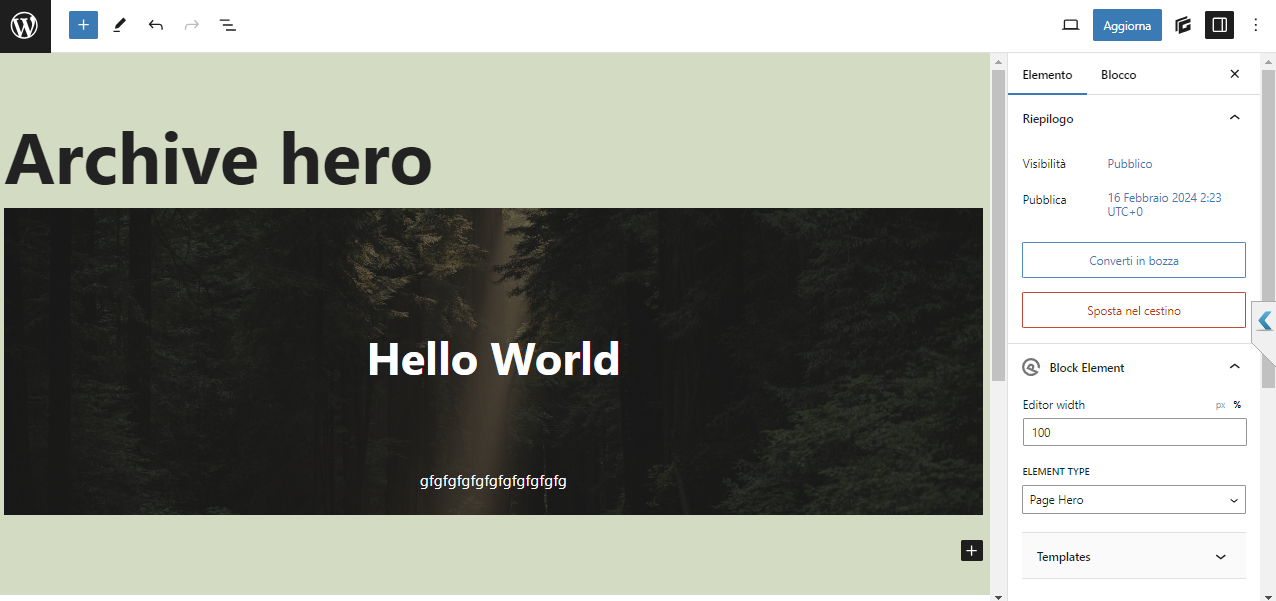

You have 2 page hero elements, the empty container is in the last element called
intestazione
.If you do not need it, delete it.
