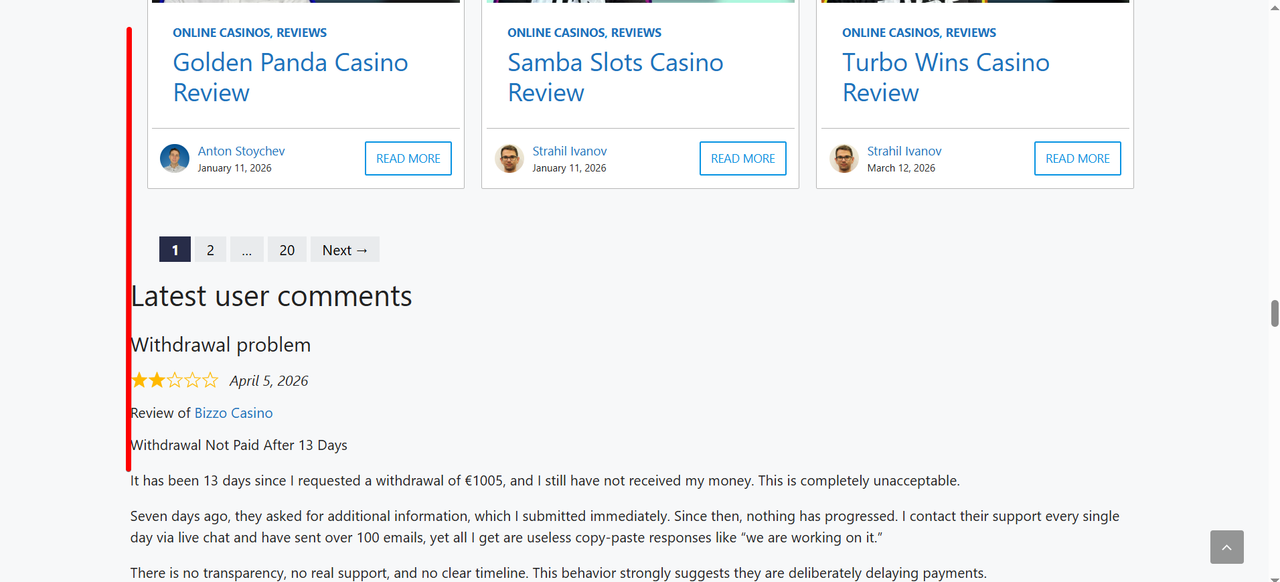

align elements vertically
    I need help with aligning vertical all the elements in one line. As you can see on the screenshot these 3 elements are not in one line. Can you help me align it as i show it with the red line.

    Regarding the gb-container-58458f6b container that wraps all the comments. Please, add a padding-left and padding-right value of 20px just for the desktop screen.
  • Thanks for you reply,
    I want to align the elements according to the element “Latest User comments” so your advice won’t help.
    Would you please suggest some other resolution.
    You seem to have this CSS:
    .generate-columns-container {
        margin-left: 0 !important;
    Try removing that.
  • Ahh thanks that helped me. I found that this margin-left: 0 is causing the issues.

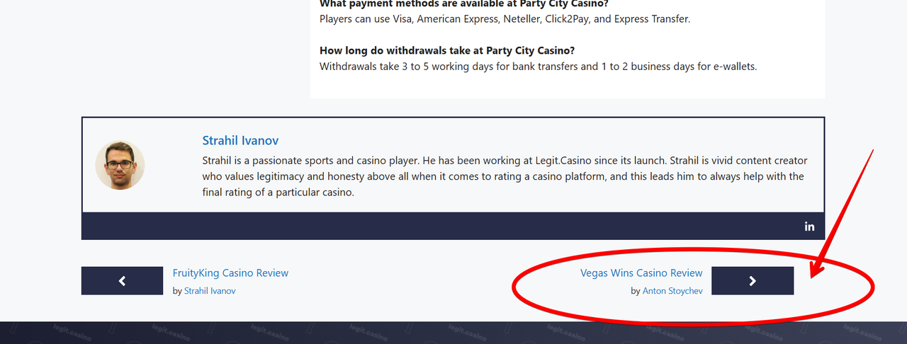

    Would you also please take a look at that page at the bottom and help me how to align the Post Navigation Element to the all other Elements on the page at the right side.. I’ve tried with minus margin but it only helps on the left side. I can’t move that Element to the right direction which is very weird.

    On the gb-container-99fe8eb7 container, remove margin-left and margin-right values.
    Then add this CSS:
    .single.single-post .paging-navigation {
    padding-left: 0;
    padding-right: 0;
    On this CSS:
    .bb-pagination, .paging-navigation {
        display: flex;
        flex-direction: row;
        flex-wrap: nowrap;
        gap: 5px;
        margin: 20px 10px;
    Replace margin: 20px 10px; with margin: 20px 0;
