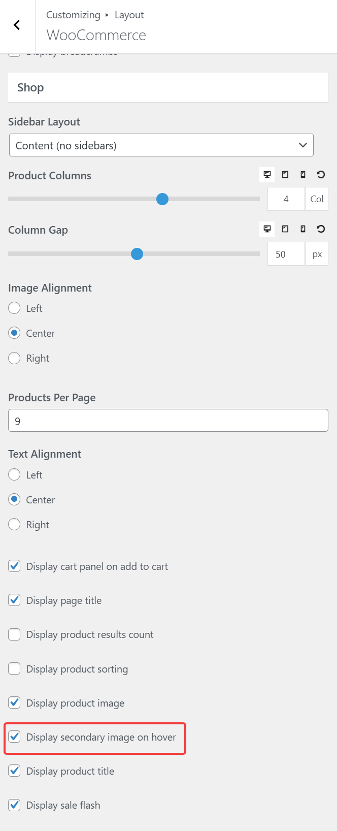

    3) the product photo changes to the 2nd gallery image, on hover
    For 1 and 2, can you show me where in the video that happens?
    For 3, Customizer -> Layout -> WooCommerce, in the Shop section there is a Display secondary image on hover checkbox.
    Woo Commerce - Display secondary image on hover
  • Ah thank you, silly I overlooked that image hover option
