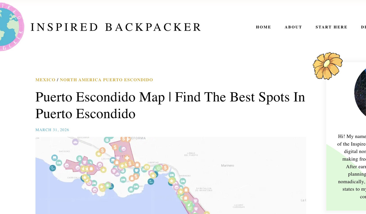

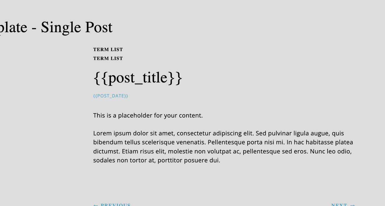

Thank you!! So I added one but it’s kind of running on after the categories even though in the Single Post Template Element it’s on a separate line. How could I make them more separated? See screenshots – for screenshot 1 I added the 2nd Term List which is for tags, and for screenshot 2 the categories are Mexico and North America, and the tag is Puerto Escondido

Hello,
Please do the following:
1. Set the tag name to a DIV for both entries (marked with red in the image below).
2. For the dynamic tag entry, you can add a separator if you want to cater for the instance where more than one tag is present.
InspiredAssistance
That worked, thank you!!!
