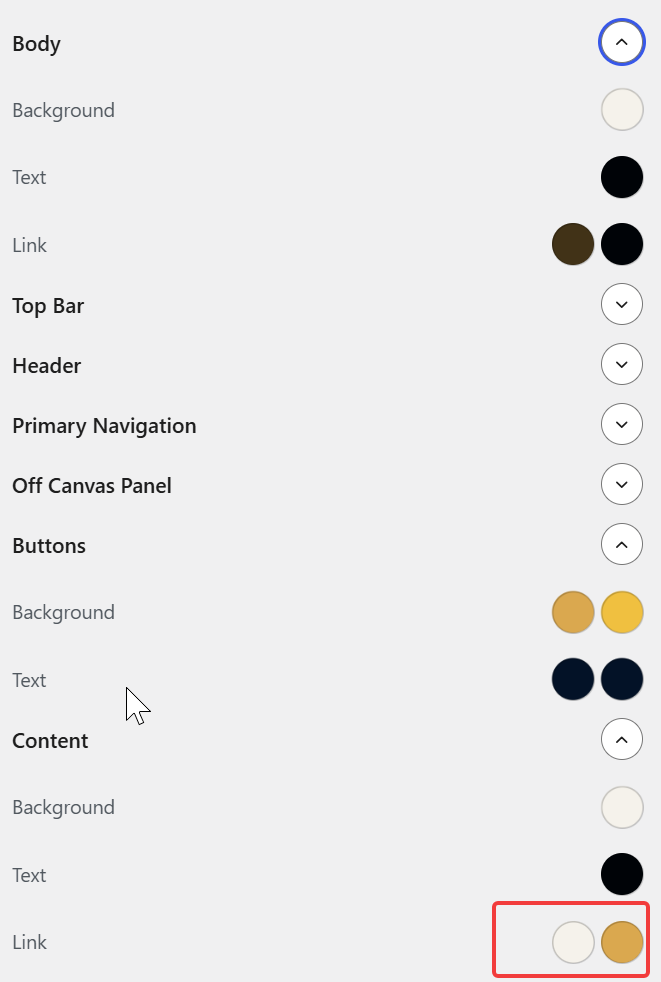

  • I cannot get a button to display the correct styles. I’ve applied a different color background and font for both the normal and hovered states, but it doesn’t not show up when I load the page. It appears correctly in the preview of the editor, but not on the live page. The button should be gold with dark navy blue lettering.
    I’ve configured this button the same as I’ve done other buttons, and I’ve tried deleting it and recreating it. There must be something I’m overlooking. Can you assist?
    Screenshots below

  • Try removing those colors from the Customizer, they usually create more problems that they solve. Use the Body colors for the links instead.
    Content links
  • That changed the color links but it did not do anything to the background color. “Watch the Latest Episode” is supposed to look like a button, but it has a transparent background even though I’ve set it to gold.
