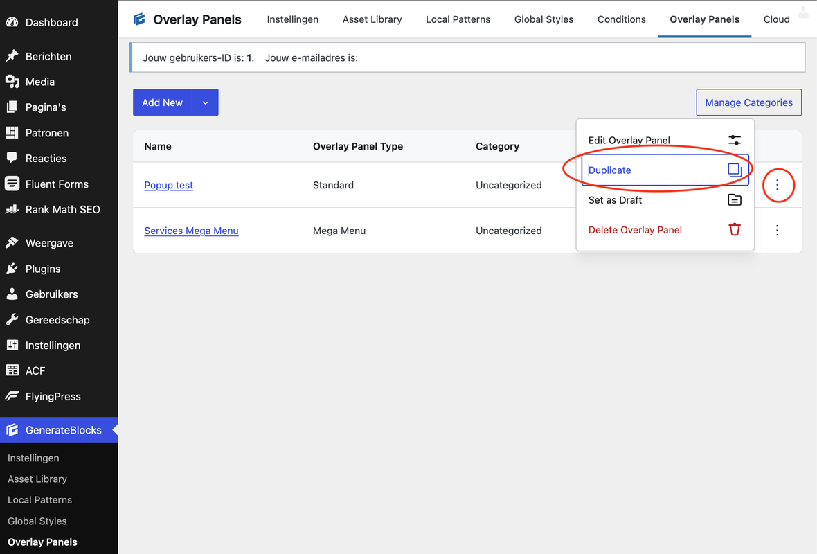

    This is probably because I duplicated one popup twice in the Overlay Panels screen.
    Is it desirable for an overlay panel duplicated in the Overlay Panels screen to get the same class?

  • So this is a bug, because I duplicated one popup twice in the Overlay Panels screen and that didn’t create new classes.
  • You are NOT duplicating the block, but the overlay panel, which is a custom post type, so it will NOT create new block classes.
    In this case, duplicate the overlay panel, then edit the new overly panel, duplicate its blocks, remove the original blocks should work.

    I understand this isn’t technically a bug, but rather how CPT duplication works.
    Still, from a user’s point of view it feels a bit unintuitive.
    In a visual builder like GenerateBlocks, it would be great if the “Duplicate” button created a fully independent duplicate right away, especially for something visual like overlay panels.
    Right now, duplication feels a bit limited since the duplicates share the same styles and can’t be edited separately, without copying blocks first.
