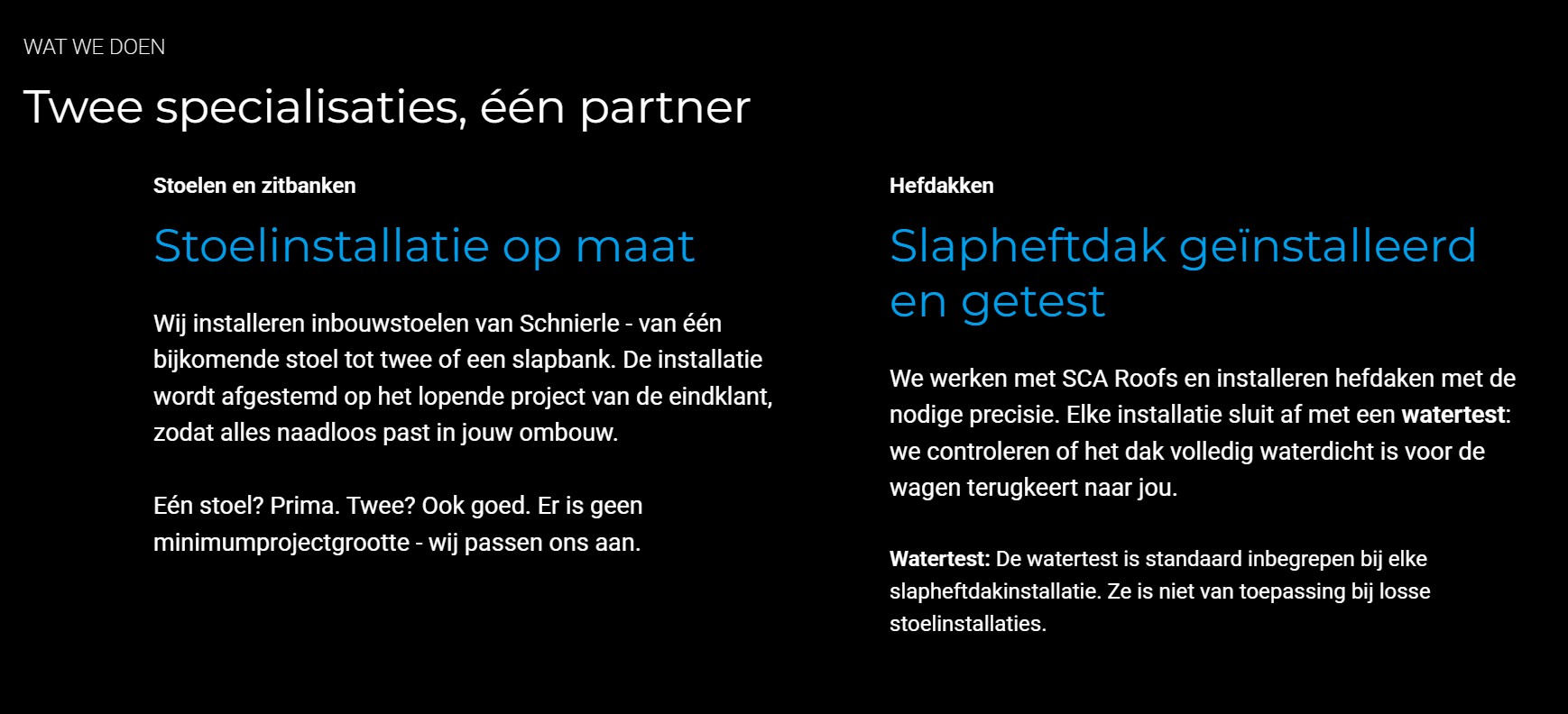

    Also this section (Wat we doen: Twee specialisaties, één partner) should be like this with the padding https://imgur.com/SmOgOdl but the inner container is showing the padding i added only in the backend.

    For the 2nd section, it looks like the paddings are applied on the front end:
    https://app.screencast.com/2zWe7P1RchBhv
    Let me know if I miss anything!

    For the 2nd section, do you want the front end to look how you have it set in the backend? See private section for screenshot.
    thank you for correcting the border.
    The second section should look like in your screenshot, yes. On the backend on my side it looks like this https://imgur.com/Ldx8ywq. Since the page is a draft i am not seeing it in an incognito browser, correct? I would have to set it then to public again.
    I am not sure what is going on here. I am seeing it like this on the backend when editing that page (which seems to be public, by the way).
    Backend
    Anyway, what is the your purpose for this layout. Are you trying to display the grid below the H2 heading with a left margin on the left? Basically, as I am seeing it in the backend?

    Yes it should look like in your screenshot. Unfortunately on my end in a private window it still looks like this at the frontend: https://imgur.com/MuS0r7L

    Could you please check on your end how this section looks? https://imgur.com/pvv1lEv it still doesn’t show as it should be (like this: https://imgur.com/6ATOZHs)
    yeah, thats what i tried but it looks like this https://imgur.com/kaJkp3h. It should be the container .gb-element-74196394, no? I set it to height to 100% that doesn’t do anything.
    Remove the 100% height from the .gb-element-cd6b9901 container and also remove the align items center value from the parent grid container (it will set the grid 100% height by default). There is also a 3rem bottom margin on the .gb-element-6ebf97e8 container, you might want to remove that.
    Just set 6em left padding only for the grid container, remove the 6em from the right padding. Seems to be some kind of block editor discrepancy.
    yes, that did the trick! Thanks for your support 🙂
