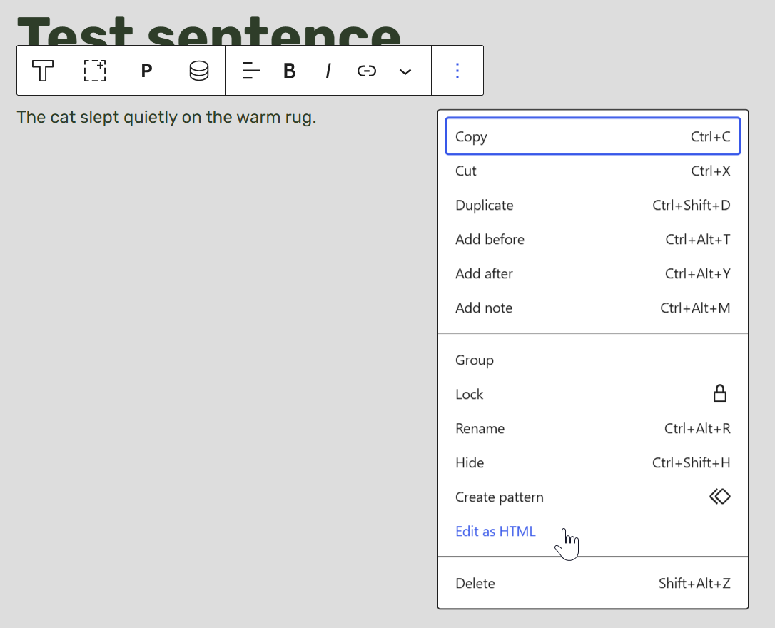

    First, edit the text block as HTML.
    Edit as HTML

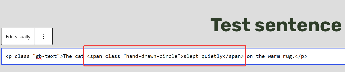

    Then, enclose the words you want with a span element including your class, like so.
    Span element
    Then, click the Edit Visually button again.

    No, if you have multiple styles, this will not work as the highlight only adds the mark markup that you can edit. You would need to enclose the necessary words with a span markup and assign a class that you then reference in your CSS.
