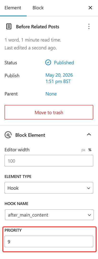

    – where do you order “after main content” blocks, if say you want to place an ad before or after loop?
    If you want to place an ad before the loop, you would create an element with your add and set the priority to a lower number than 10. eg: 9. The related posts element has a default priority of 10, of course, you could always change that as well.
    Element priority
    For the ad to appear after the related posts element, the priority would need to be higher, eg: 11.
    The lower the priority number, the higher it will appear on the page under the same hook!
