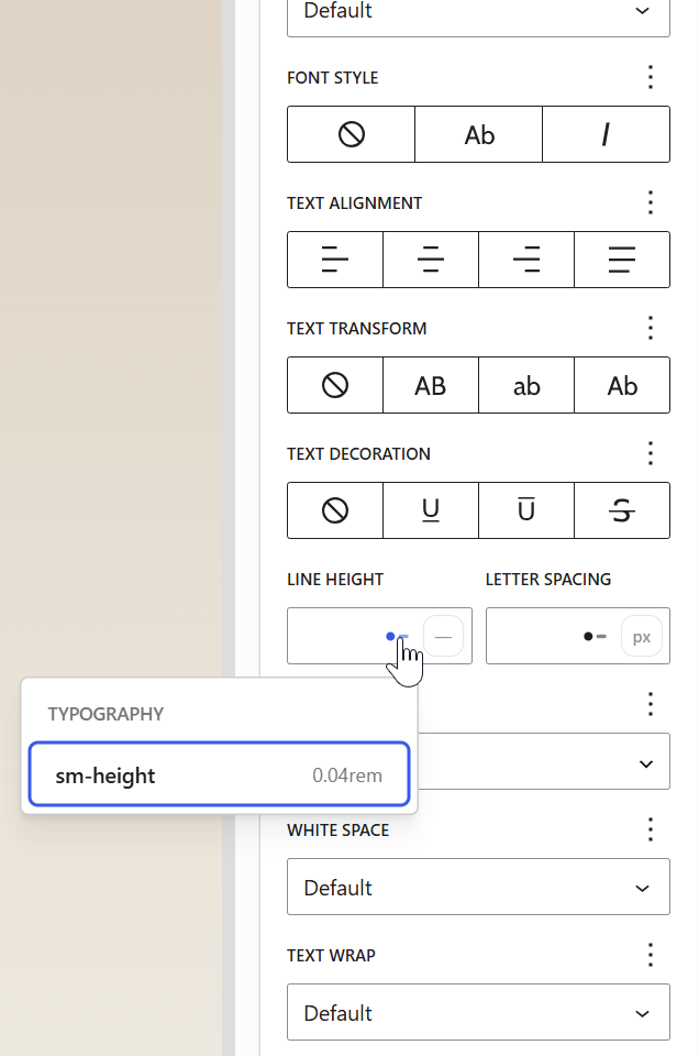

    And Line Height I have to just remember the name and typ it directly into the field. The Unit token presets in the field would be more logical.

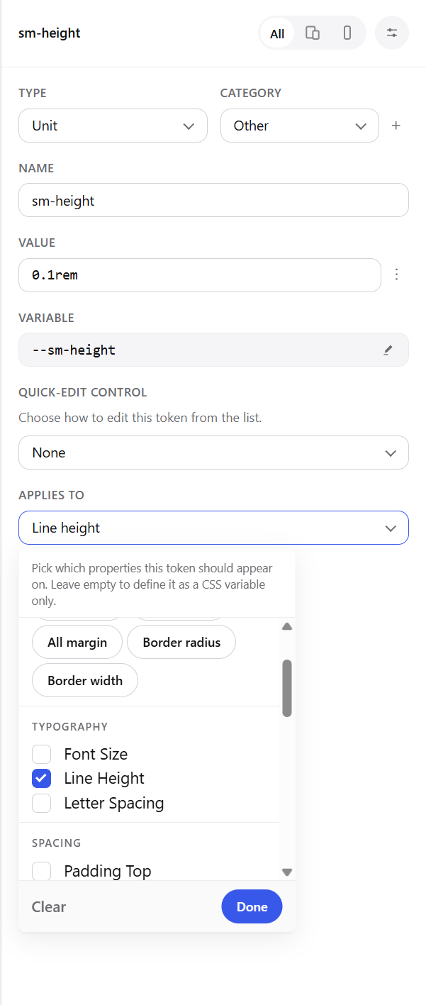

    For line height, you would create a Unit type token, name it and set the value, then apply it only for Line Height.
    Unit token
    Then, you would select it from the token dropdown in the editor.

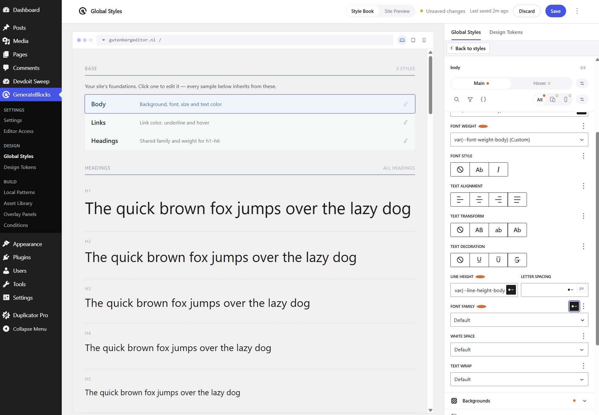

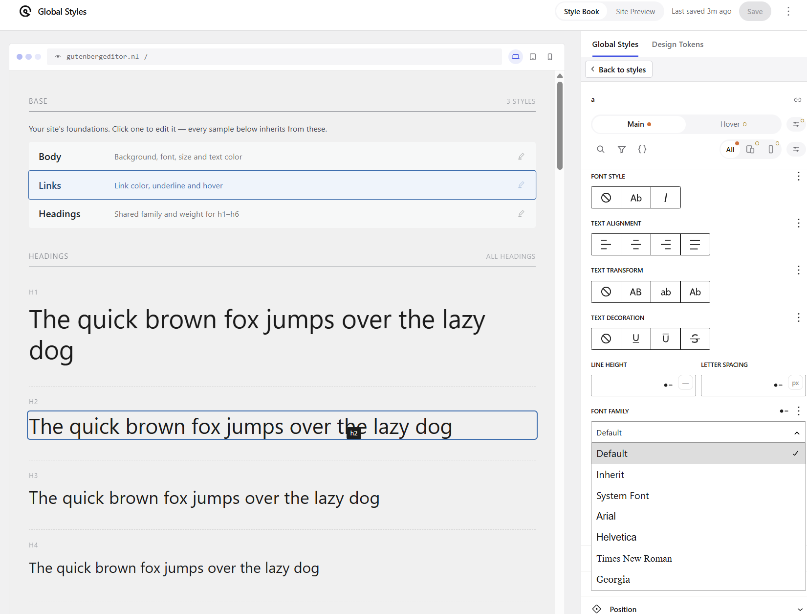

  • I noticed somehting strange. Could you check on this? When I use Text Token presets for Font Family it doesn’t shows it.
    This is default:
    Default
    Here it still says default:
    doesn't show design token
    The select box needs an update, as currently it is still wired to the Font Library method.
    To use a design token :
    1. Click the token button above the select box and set it there.
    2. Ignore that the select box says default.
    Future updates will improve this UX.
