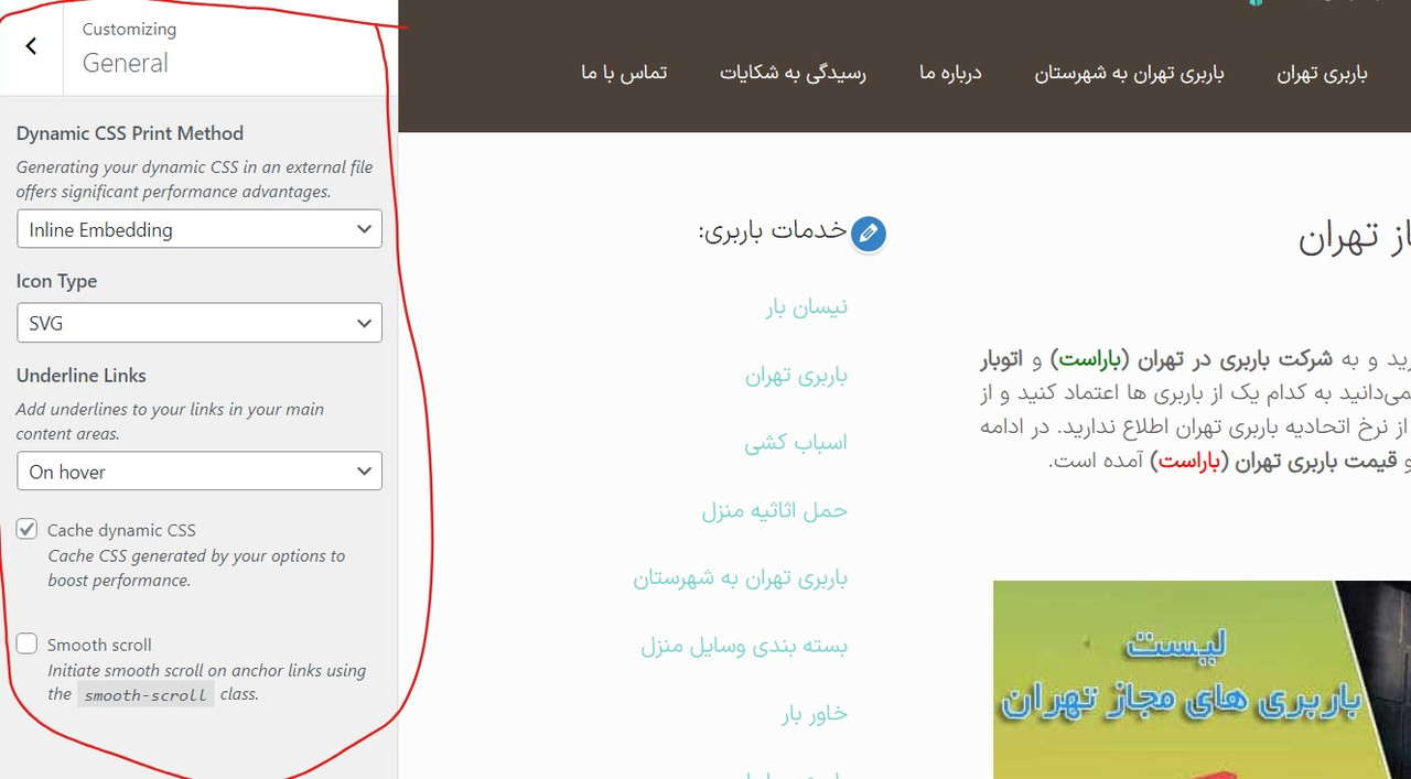

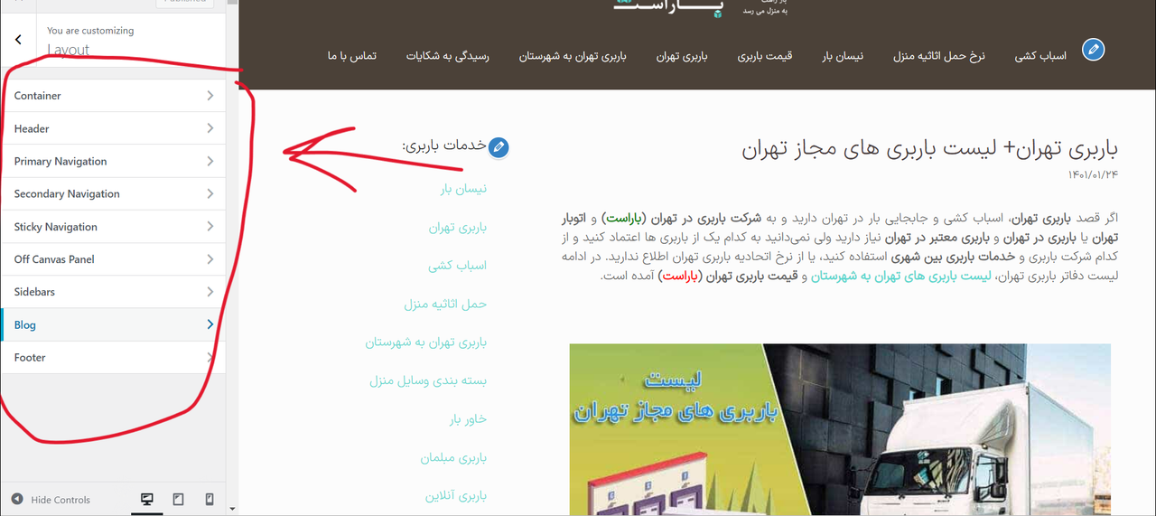

    I bought the latest plugin (Version 2.3.1) yesterday and all its modules are active, but some features are missing
    Like Dynamic Typography
    Now look at my screenshot and the image of the site:
    There are many examples that I can give
  • sorry wrong picture:
    correct:

  • To clarify, is the entire General section of the Customizer missing? That should be appearing by default.
    If it is, can you try #1 here to debug: https://docs.generatepress.com/article/debugging-tips/

  • missing feature:
    Switching from Floats to Flexbox
    The latest version of GeneratePress uses Flexbox and Dynamic Typography as standard.
    Those options you mentioned eg,
    Switching Floats to Flex
    Use Dynamic Typography
    Only show on older sites that were built before we introduced flexbox and dynamic typography.

  • You don’t need to do anything.
    If you do not see the options then that is because you’re using the latest version of the theme.
    And the latest version ONLY has the Flexbox and Dynamic Typography. And there is no option to change that.
