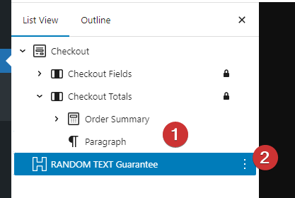

Do GeneratePress WooCommerce Hooks ONLY WORK with the legacy checkout? Specifically on the checkout block page.
I tried to edit the checkout page itself, and add a Generateblock for example, and it does not let me drag and move that around…
1 = default paragraph block
2 = generateblock (unable to move, everything is locked, so i need hook 🤬)—
Just wondering, because I’m playing around with a block element and I see it loading on the checkout page, but it doesn’t actually display any text. In my example, it’s just some random text using hook “after_order_notes” but I tried a bunch of other hooks/priority and still no display. Testing on local environment so I can’t share link.

I already mentioned in original topic this is not possible and I even shared a picture. Whatever, all good. Happy Saturday!
Yes, the checkout block only allows the paragraph block to be added in and dragged around for simplicity.
As it’s a block, there’s no hook.
