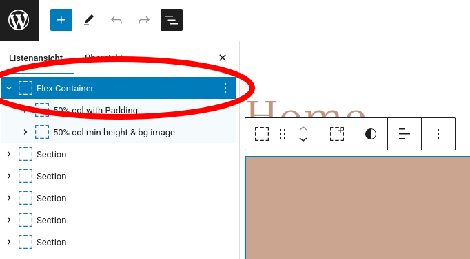

    On the Wellness homepage there is a “Flex Container”:
    Flex Container
    How do I create such a container?
    Please assist.
    Kind regards,
    Jörn.
    It’s just a container, the Flex Container is the label of the block, you can add/edit/remove it by clicking the 3 dots icon, and click Rename:
    https://app.screencast.com/H5EeSEw6nNRQE
    To set a container to be display:flex, you can do so in the Styles panel in the right side bar, you will find the option under layout panel (first panel).
    https://app.screencast.com/96JRdv4DrovG8

    In fact, all tutorials I found described how to use the flex technique. No mention the the label “Flex Container” is generated by a renaming.
    My impression was that “Flex Container” is something which I could reach straight away from the list of block items.
    Thanks for putting me back on the track.
