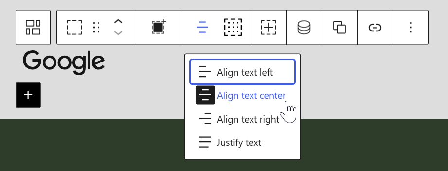

    You can center align each logo container.
    Logo flex containers center aligned
  • Thanks for your suggestion. I found the issue was actually that the logo containers on mobile still had a width of 33.33% applied. I’ve now changed those containers to width: fit-content as well, and everything is evenly spaced as expected.
