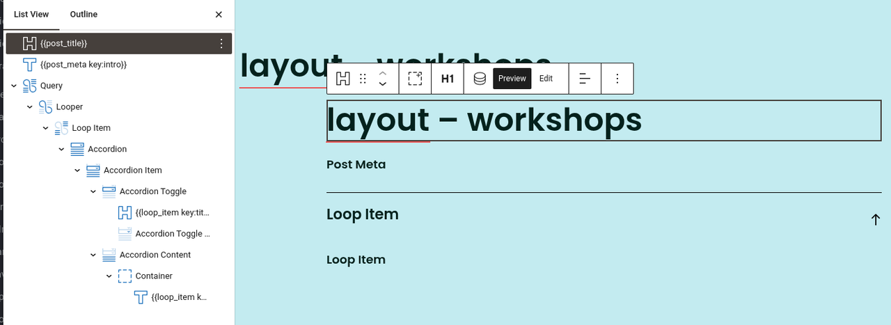

    I’ve a query loop which put data in an accordion, generating then for each content an accordion.
    https://i.postimg.cc/bvxcnd7D/Screenshot-from-2025-01-31-19-52-48.png here the structure.
    Is there a way to keep the first accordion open on page load and the other closed?
    (since the three are single accordion and not items the “open by default” option will apply to all of them.
