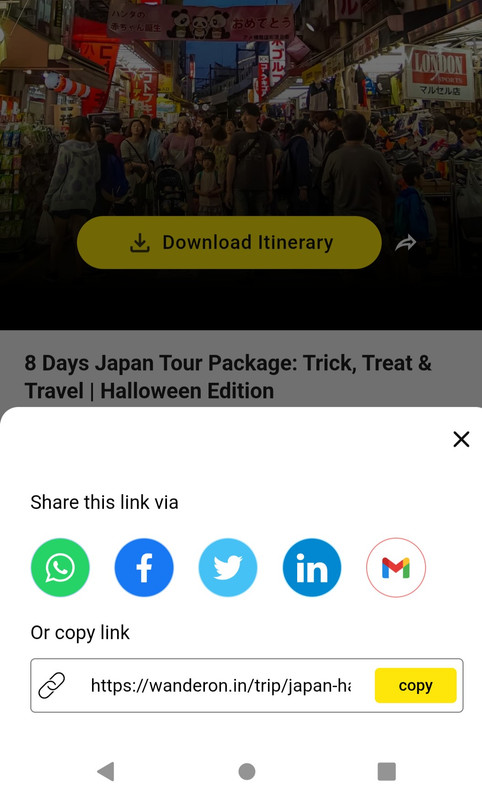

  • Hi, i wanna make my modal to be at bottom for mobile, like this;
    https://i.postimg.cc/jdWjjP7r/Screenshot-20251028-183912.jpg
    I tried adding a wrapper of full width and height and place the inside modal box accordingly, which was perfect.
    But it won’t let my modal close on clicking outside. As I can see by default there is GenerateBlocks overlay div i guess…
    What would be the solution?
    Thanks….

  • Click on the “Share Icon” in the Hero section in Mobile.
    The modal is placed at bottom using the outer wrapper.
    But because of that wrapper i added, closing by clicking outside is not possible now…..
