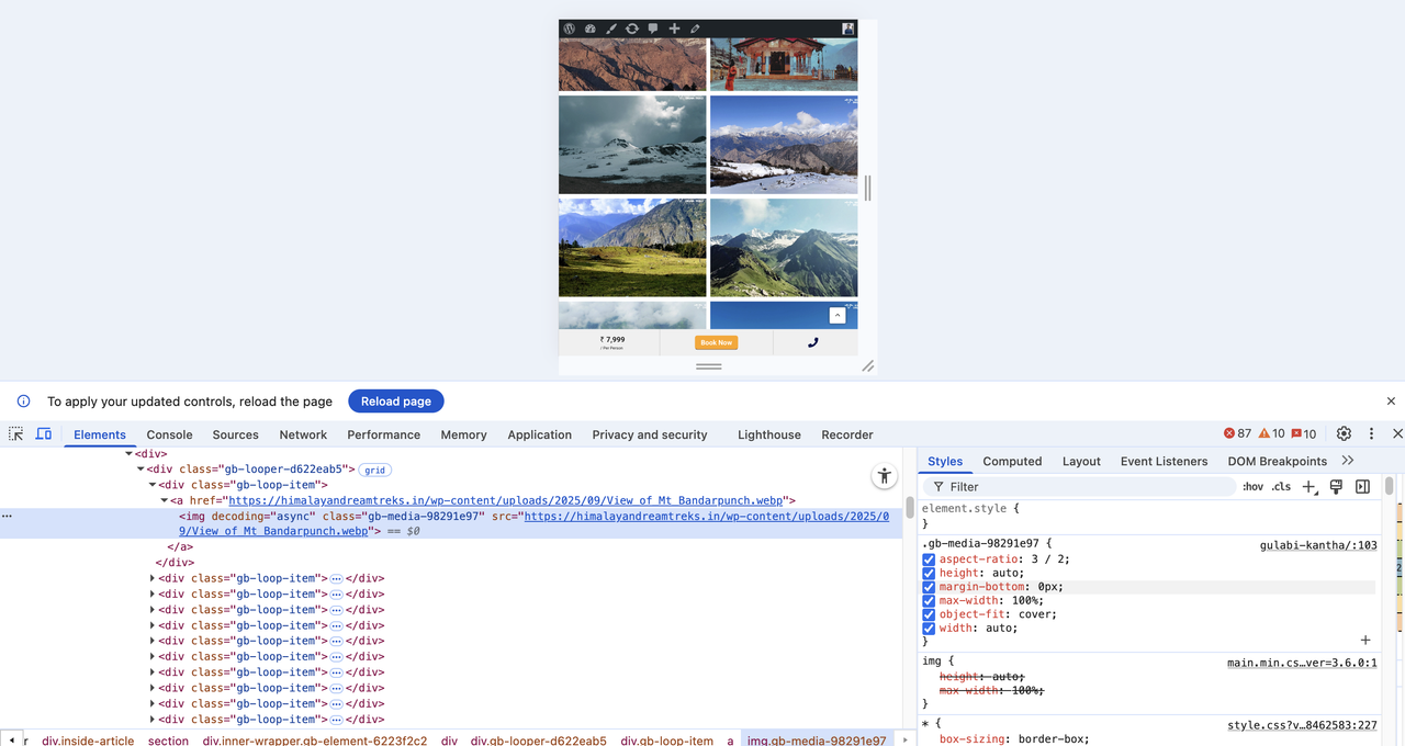

Hi, i have a dynamic gallery inside a Single Post template, ACF gallery field and then outputting using GB Query loop.
But i can’t see any alt text and so on. And my client is notifying the images are not indexing.
I guess that is the primary reason. Please check the below’s screenshot…
https://i.postimg.cc/J00wJ04D/Screenshot-2025-10-24-at-6-46-49-PM.png
Thanks…)
GB simply outputs the image, it does not fetch other attributes of the image, which is expected behaviour.
In this case, you might need to swap to ACF’s shortcode to display the gallery and see if that works.

You can add the alt attribute to the image by using the dynamic tag {{loop_item key:alt|required:false}} in the ALT Text field: https://cln.sh/qsFbX4MPDHqgcbf1cCqR
Let me know if that works.

Working but when the return format is ‘Image Array’.
Can’t we do for image URL?
Thanks.
Also i would be great if we can make the loop item ‘<figure>’.
If you’re using a ACF field that returns the Image Array then you should use:
{{loop_item key:ID}}for Image URLAnd that should auto populate the other attributes including the
alttag.

Thanks a lot David.
It fixed everything.
