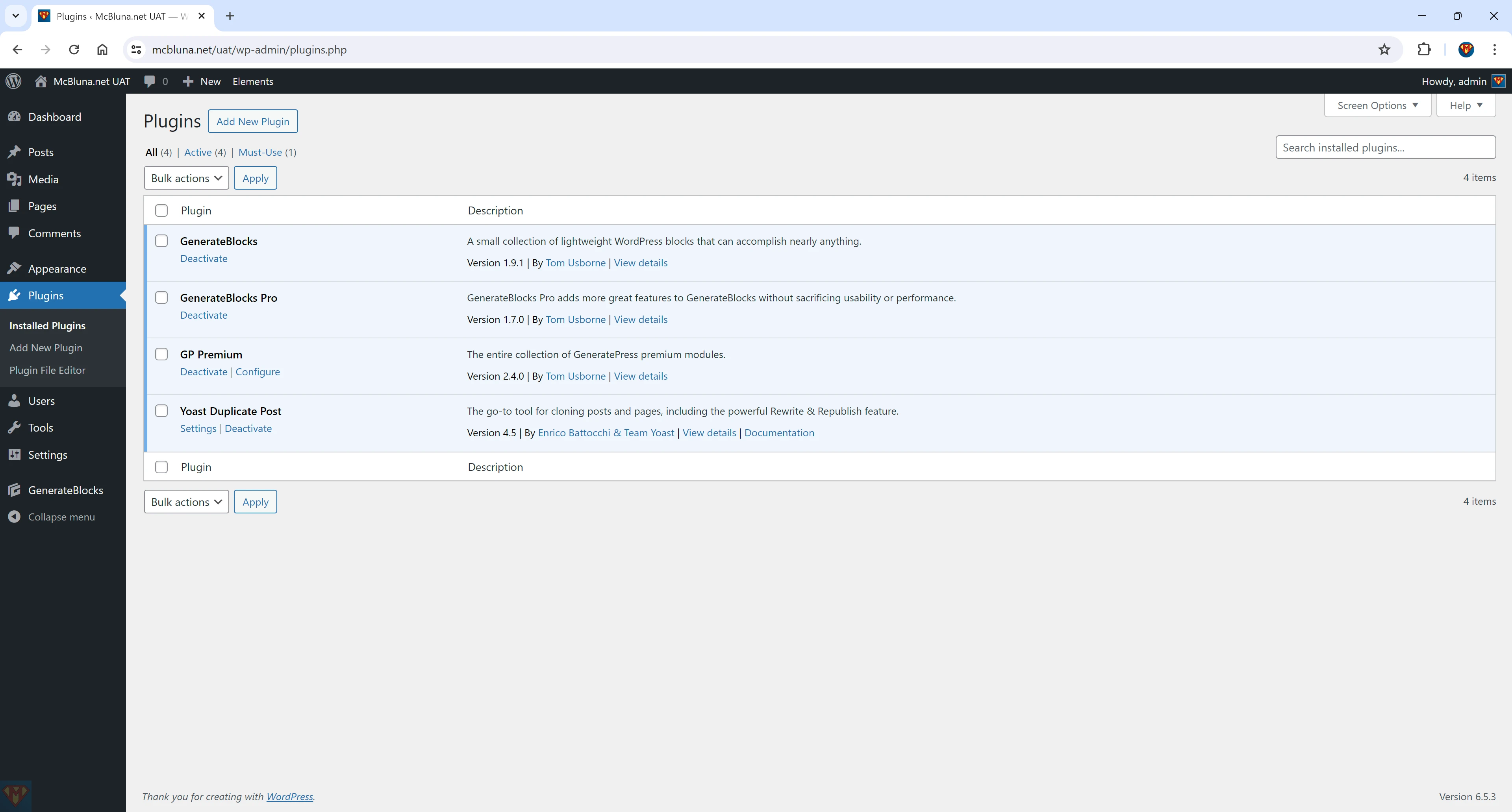

    Plugins installed: GenerateBlocks 1.9.1, GenerateBlocks Pro 1.7.0, GP Premium 2.4.0 and Yoast Duplicate Post.

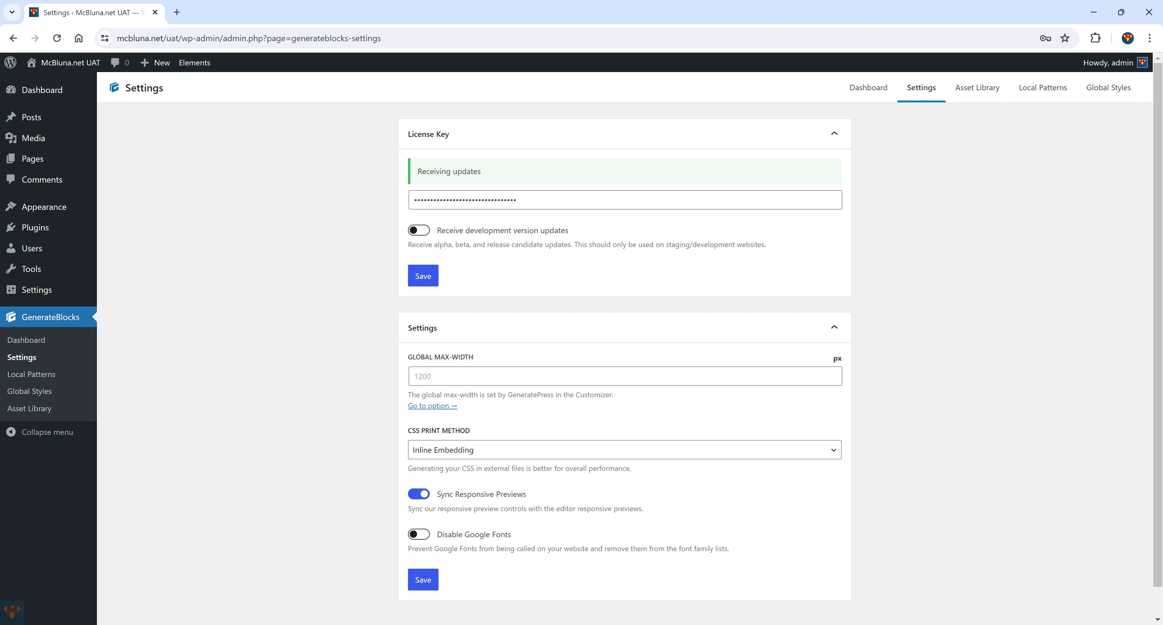

    Plugins
    GenerateBlocks Settings -> CSS PRINT METHOD -> Inline Embedding

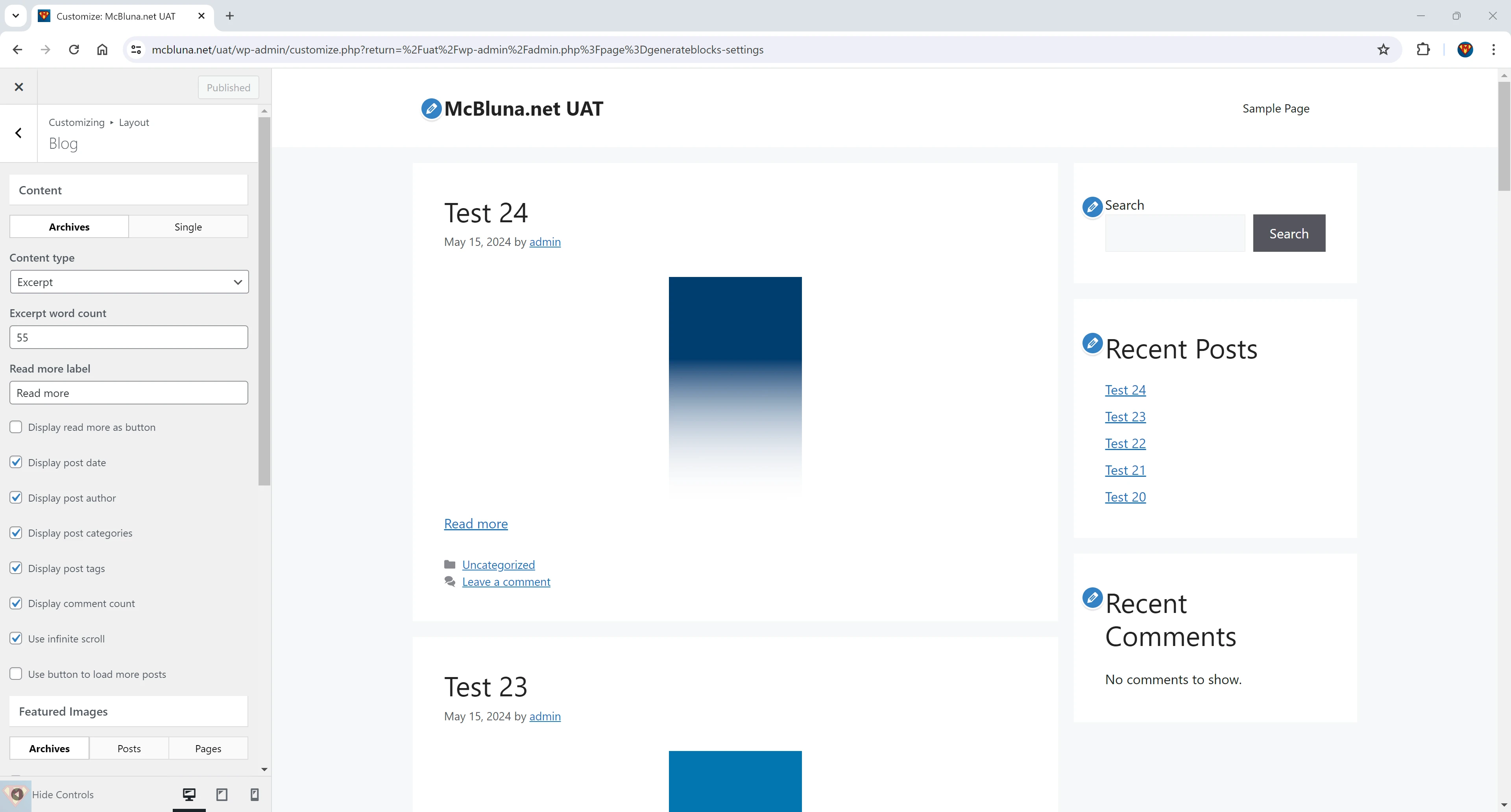

    Appearance Customize – Use infinite scroll
    Customizing Layout

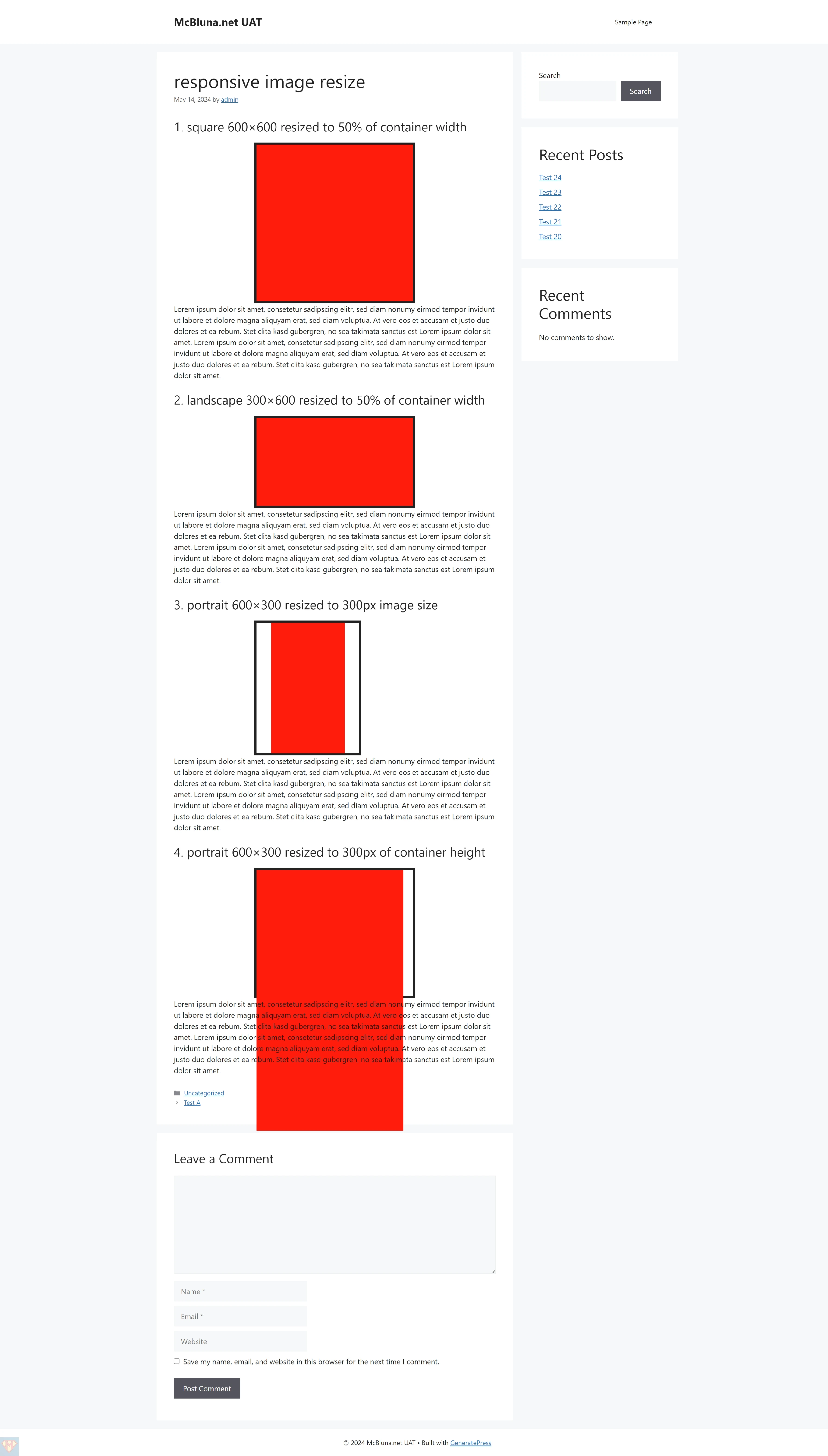

    I would like to use a container to responsive resize the image inside it. For images in square (1.) or landscape (2.) it works, but how to do it correctly for images in portrait (4.)?
    I don’t want to set the size for the image manually each time and even if I do, the size of the container in the middle is not 50% anymore. (3.)
    responsive image resize
    responsive-image-resize
