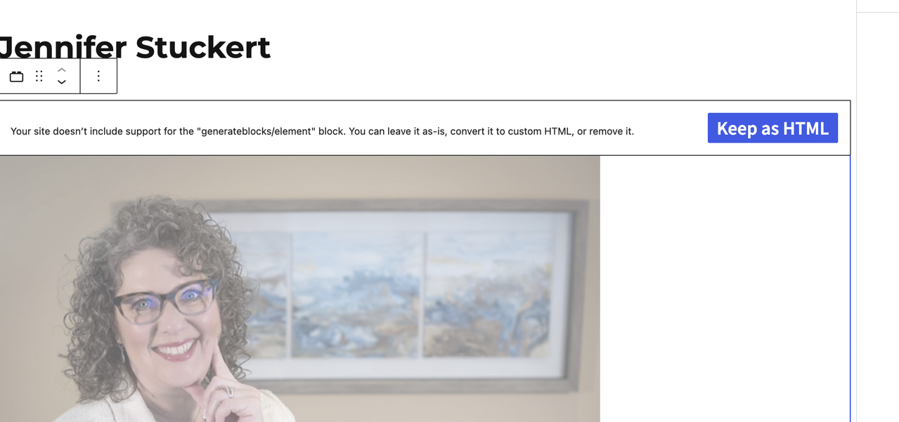

Getting the error about site not including “generateblocks/element”
  • Screenshot: https://i.postimg.cc/VkXR94rK/Screenshot-2026-07-10-at-9-04-12-AM.png
    I have updated, cleared my cache, switched between generate press and my child theme, I’ve deactivated all plugins except gp premium and generate blocks – and I still get the error in edit mode.
    I set this site up about 2 months and did not get the error then. The block is displaying correctly.
    Here’s and example page from the website – though the error is on all pages:
    https://restorationcoachingatl.com/jennifer-stuckert-2/

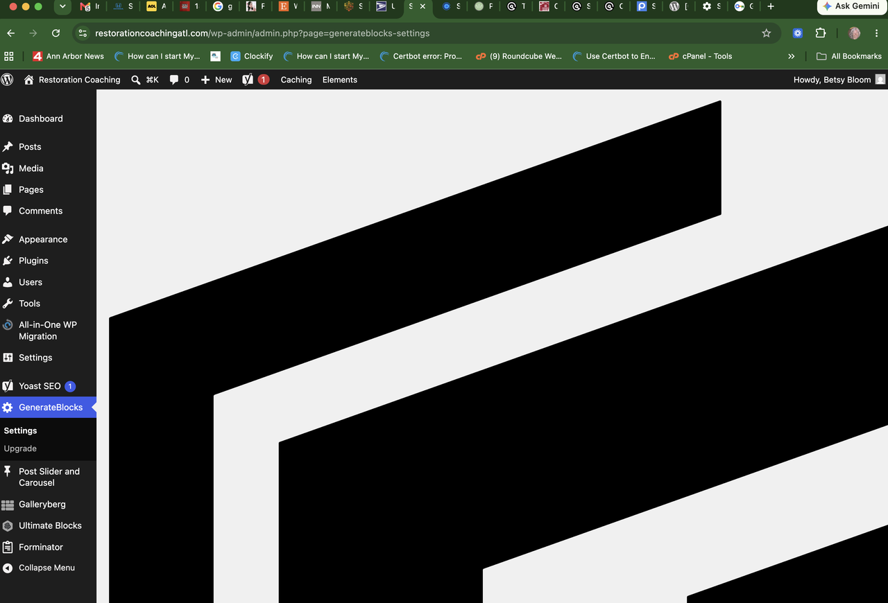

    Here’s what it looks like on the blocks settings page – the only link that works is “go pro”
    https://i.postimg.cc/Hnhg2dKV/Screenshot-2026-07-10-at-9-09-58-AM.png
    What GB version are you using?
    Can you try disablling all other plugins and switch to the parent theme to test?
    Let me know how it goes!
  • I switched the generate press parent theme and disabled all plugins except GP premium (2.5.6) and generate blocks (2.3)
    And I switched the generate press parent theme.

  • So does the issue still occur?
    If so, can you provide an admin login and keep all plugins disabled?
  • The site is a live production site – I can keep the plugins disabled for 24 hours.
    I’ve reinstalled the GenerateBlocks plugin on your site, and that seems to have fixed the issue.
    It’s possible that some of the plugin files had become corrupted, which may explain why the settings were previously inaccessible.
