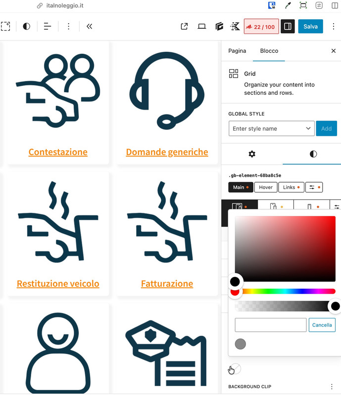

    I discovered just today that the color picker shows only one color (grey) and not the ones set in the customizer:
    Color picker
    I used the referenced global color all over the website, so the reference is working, the colors are set properly, but the editor does not show them in the color picker.

  • After a small investigation, I found that the problem is a conflict with Kadence Blocks.
    Since I am using that only for one crucial thing on the website (a slider), I cannot just replace the plugin.
    What do you suggest to do?
    The latest version of GenerateBlocks Pro now supports carousels and sliders, you could use that!
