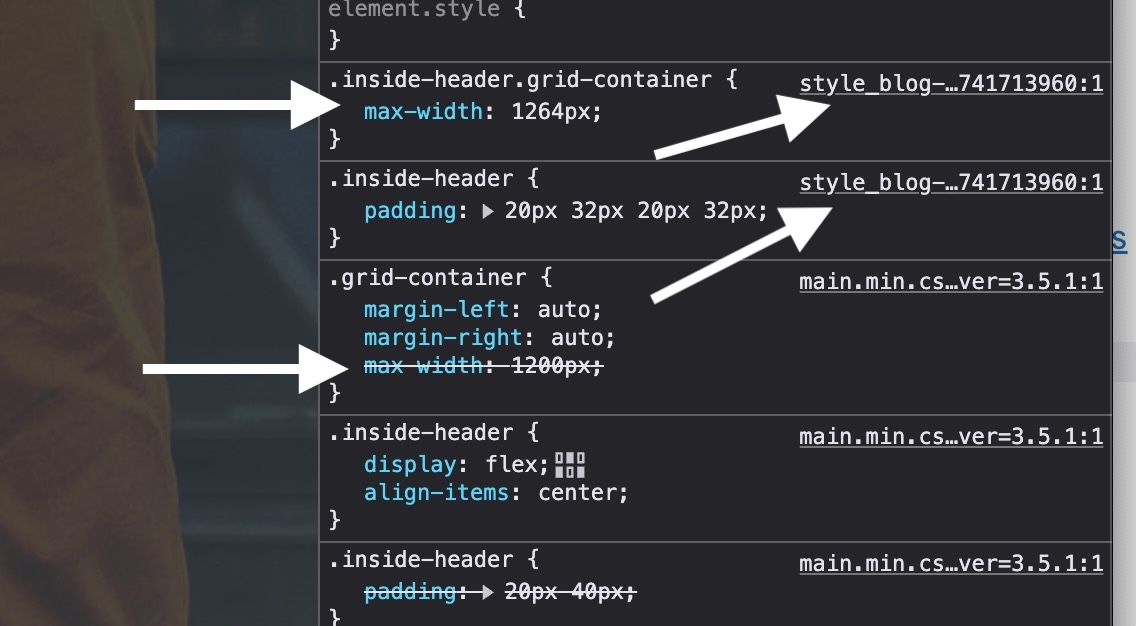

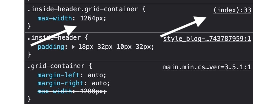

    However, on the example site, it would seem the .inside-header.grid-container {max-width: 1264px;} is being compiled into the minified stylesheet where the rest of the global/customizer settings are being placed. When I add it with a hook element, the system puts it inline into the <head>.

    The CSS question comes when I can see the CSS handle being added within the GP minified CSS file as opposed to be added inline in the head like when I use a hook element.
    Hopefully this image helps better explain?
    GP global CSS
    And here’s what I’m seeing on my test site when I add via hook element:
    GP global CSS

    I usually won’t use hook element to insert CSS, you can use customizer > additional CSS (inline) or the style.css file in a child theme (external file), or create a global style (external file).
