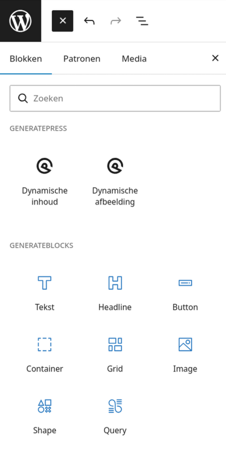

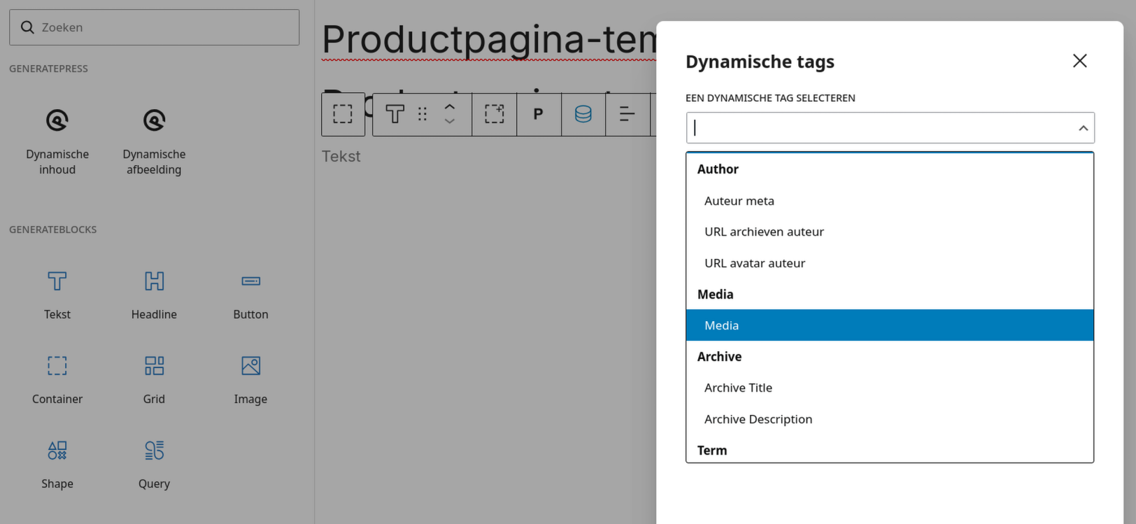

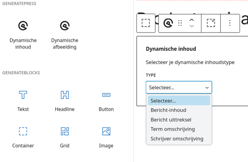

  • 1. Dynamic Content – Pull product information (title, price, image, description, custom fields) directly into your GenerateBlocks layouts
    I’m having trouble with this. I’m trying to build a custom product page layout: hero (container), with a background image (dynamic: product image1), with an overlay: product title (this is the only one that works for me), product price (can’t find it anywhere outside of the regular product-template-block (which I can’t get it out of)), and more product meta elements that I cannot seem to dynamically insert into the GB layouts. See attached screenshot for the options I’m seeing ‘out of the box’.
    I’ve tried using tags like {{wc_price}} and variations to those kinds of tags but nothing works for me. What am I missing?
  • In WooCommerce, the custom fields (post meta keys) for product pricing are:
    Regular Price: _regular_price
    Sale Price: _sale_price
    These are stored in the wp_postmeta table and are prefixed with an underscore, which makes them “hidden” custom fields in WordPress.
    A few related fields you might also find useful:
    _price – The active price (automatically set to sale price if one exists, otherwise regular price)
    _sale_price_dates_from – Sale start date (Unix timestamp)
    _sale_price_dates_to – Sale end date (Unix timestamp)
    Anything else, let us know!
  • Thank you! I managed to get the prices displayed in the frontend via post meta along with the meta key you provided.
