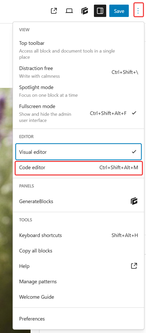

    Meanwhile, I have provided a link the private section with some JSON code for you to go and copy. Once you have that code copied, edit the homepage and enter the Code editor from the three dots at the top right.
    Enter the Code editor
    Then paste that code at the top of the existing code and switch back to the Visual Editor.
