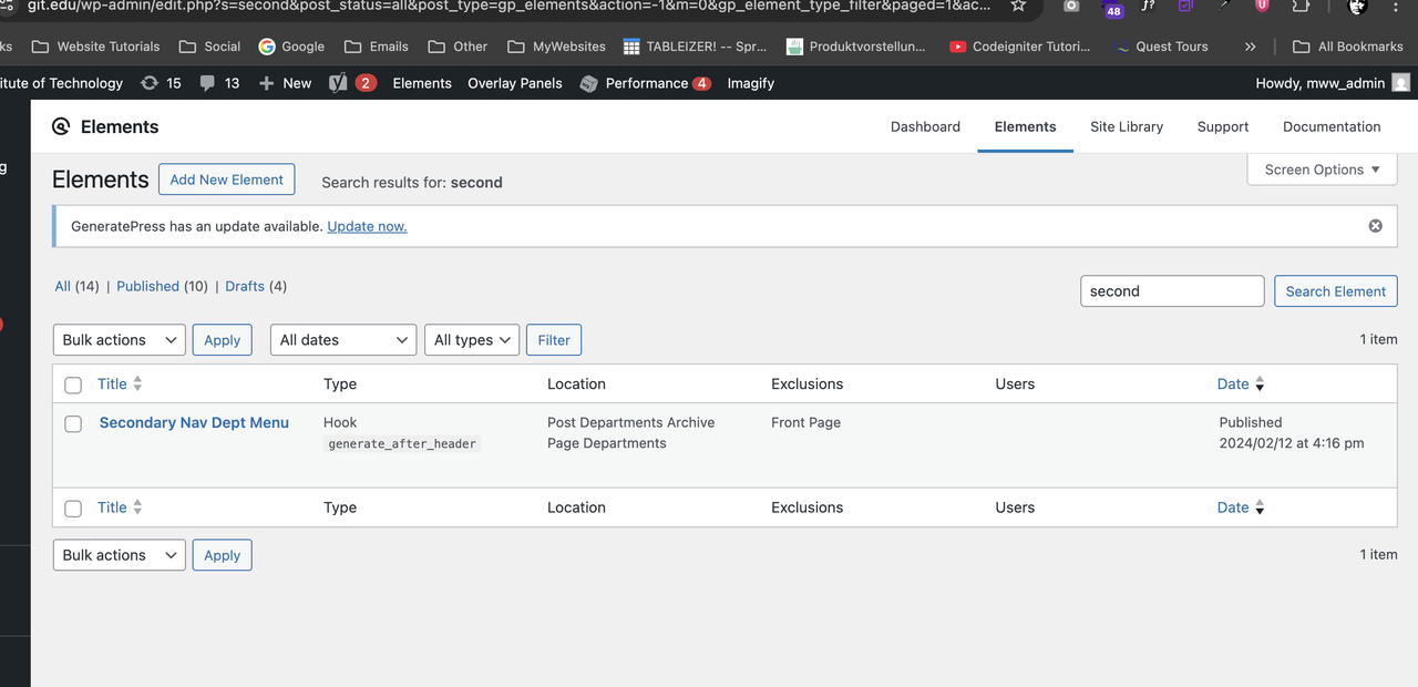

Hi, I’m trying to add a menu on some pages using hooks.
I have added the below code<div class="second-nav"> <?php if ( function_exists( 'generate_secondary_navigation_position' ) ) { generate_secondary_navigation_position(); } ?> </div>Issue is no matter what i add in the hook, it is not getting visible for non logged in users. but this appears for logged in users.

What’s the hook name you used on the element?
chetanpatil
Here is the hook details:
https://i.postimg.cc/9XtkkFPk/image.png -
I’ve checked the element settings, and there’s no apparent reason it shouldn’t display on the frontend. Do you have a staging site where you can safely deactivate all plugins to test for a potential plugin conflict?

The issue is that your site is built with Elementor, and GP hooks only work in GP’s default template.
Since you are using an Elementor header, so
generate_after_headerhook does not exist on your site.I’ve changed it togenerate_inside_containerand it works.Here’s the hook visual guide, hope it helps:

The issue is caused by the PublishPress Permissions plugin. I deactivated it, and the navigation is now displaying correctly.
