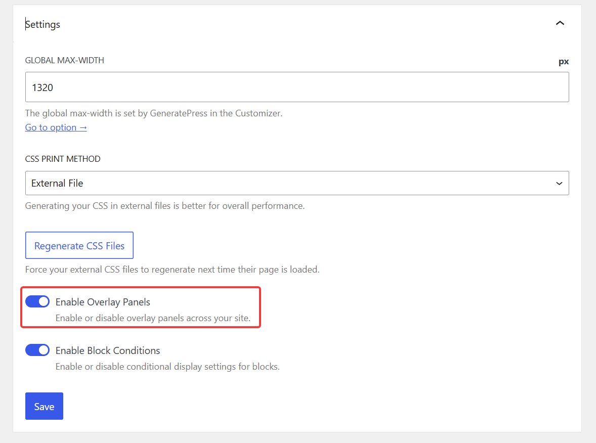

    1. Make sure Overlay Panels are activated from GenedrateBlocks -> Settings
    Overlay Panels active

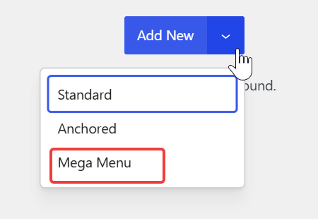

    2. Create a new overlay panel as a mega menu from GenedrateBlocks -> Overlay Panels.
    New overlay mega menu

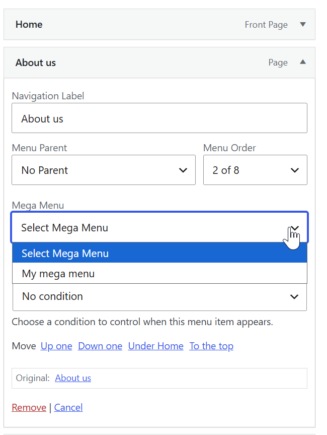

    5. Assign it to the menu item in your navigation.
    Assign maga menu to nav menu item
