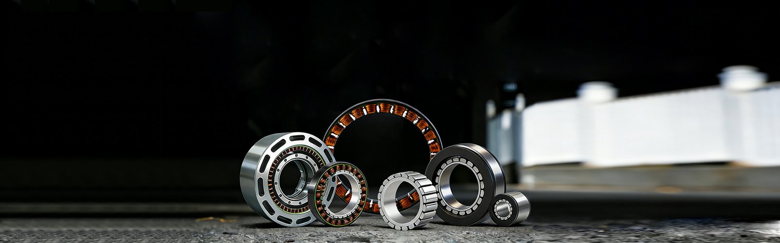

  • HI George
    i just found the issue about image display
    https://www.iihuan.online/wp-content/uploads/2026/01/999.jpg
    inside the hero slider carousel https://prnt.sc/Q7KBIkes1E5i
    https://prnt.sc/OjZJV4zqf2Hq
    The content within the red box at the bottom of this picture has been automatically cut off.
    why? how to fix it to normal
    but inside the page, also the same hero slider carousel
    https://prnt.sc/It4O4Fi3Oyga
    On this postion, the whole images display normally in the slider.
    why there is different ? how to fix it on full width silder hero carousel
