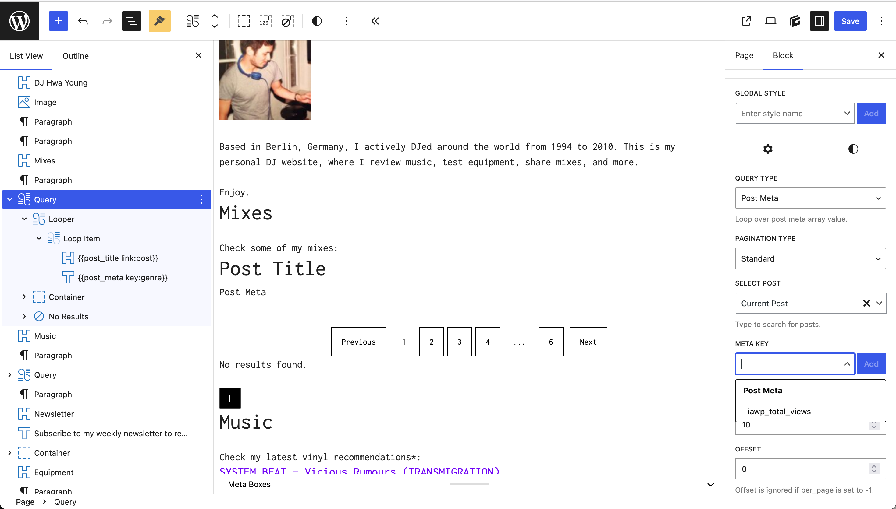

  • Thanks, but I’m still not quite getting it.
    When I change the query block type from “Post Query” to “Post Meta”, I don’t see a way to select the “Recordings” CPT for the query. Screenshot.
    Also, I can’t seem to apply the “genre” meta key.
    I assume there are a few additional steps required to achieve the desired result?

  • You need to nest the Post Meta Query block inside the main Post Query block, like this:
    https://cln.sh/fPkkkGJnW9Hwy0169lQ3
    If the genre meta key is not listed in the Meta Key dropdown, you can manually type genre into the field and click Add.
