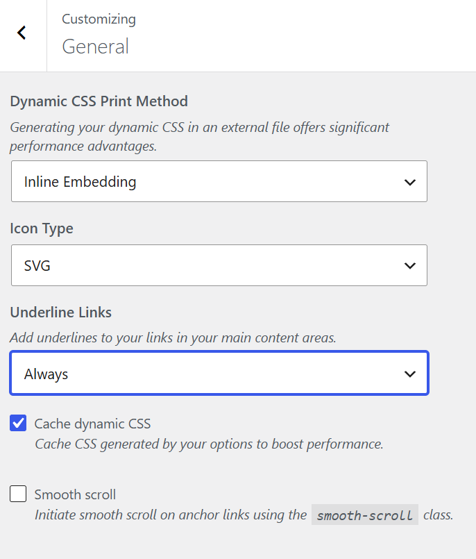

Hello,
It seems that your site has links underlined set from the Customizer. You can check this under Appearance -> Customize -> General.

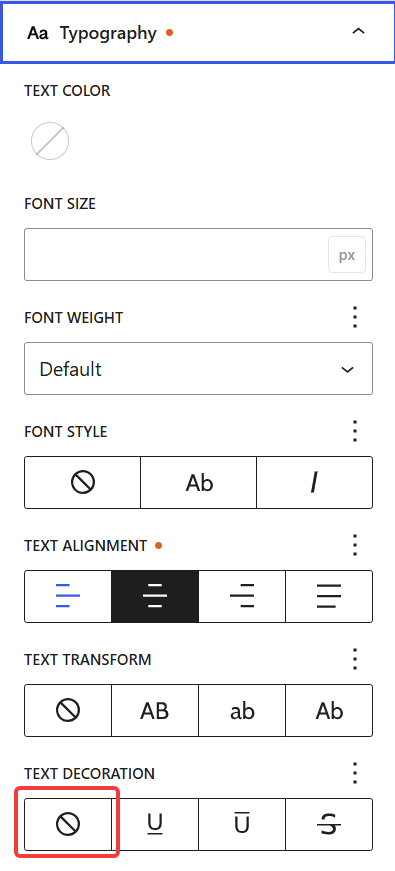

You have two options:
1. Set that option to
Never.
2. If you want to keep the underline, set the button’s text decoration toNone.

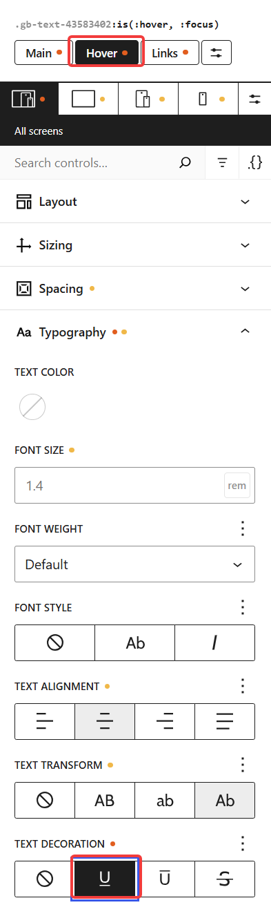

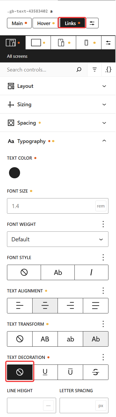

i have done this setting, when I am hovering these heading titles (https://prnt.sc/NohL9xER-ops), why it does not show the underline under this titles?
pls help to fix that, thanks
George
Hello,
That’s because you have set the links selector to be not underlined in the block editor.
The hover inherits from this style. Go to the Hover & Focus selector and set the underline there.
