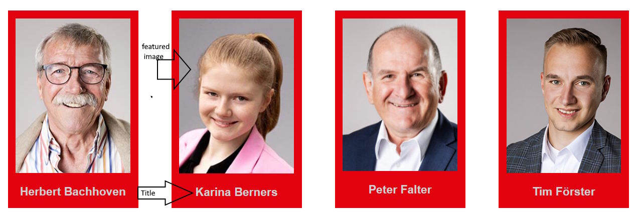

    This is what I want to achieve:
    Layout

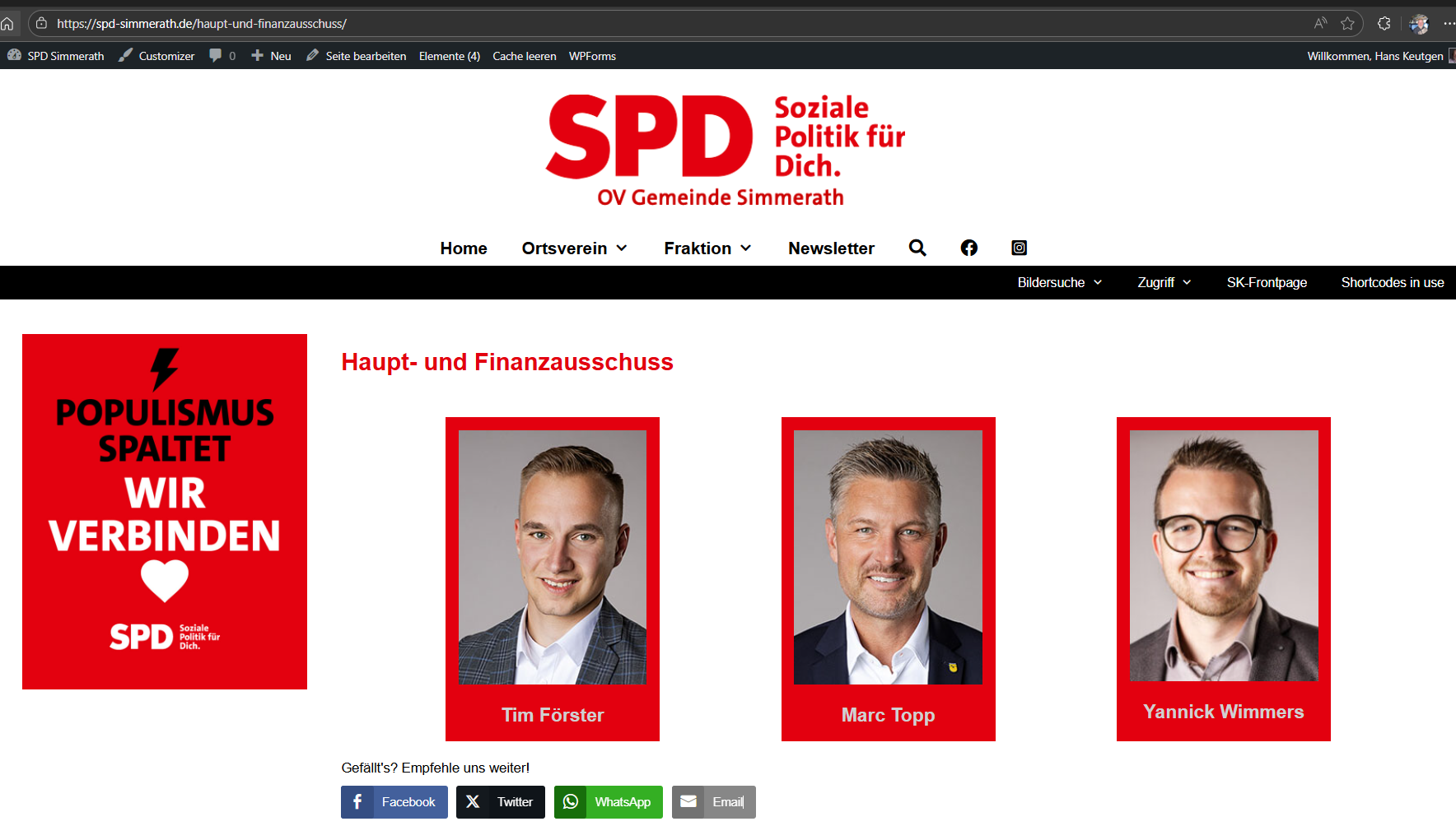

  • I generated an example page which shows what I want to achieve.
    HFA
    And this is the code.

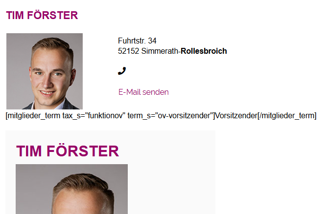

    And this is the result.
    Output
    The shortcode is activated!
    I cannot find an error. Do you find it?

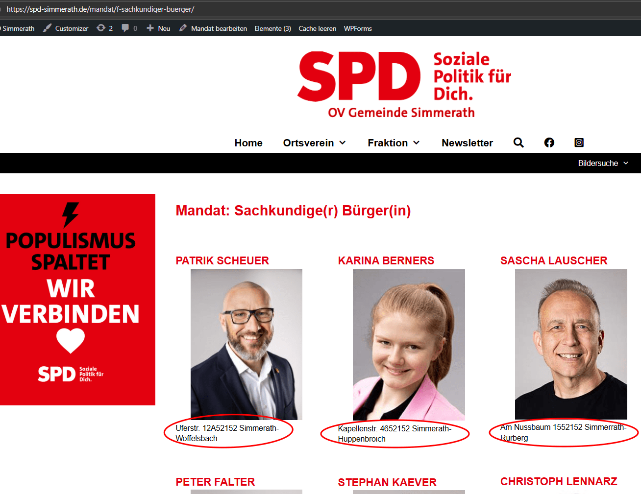

    The last picture is created by a loop with system output with a layout which I don’t like.

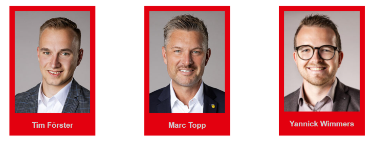

    It would be great if the layout would be like this:
    Layout
