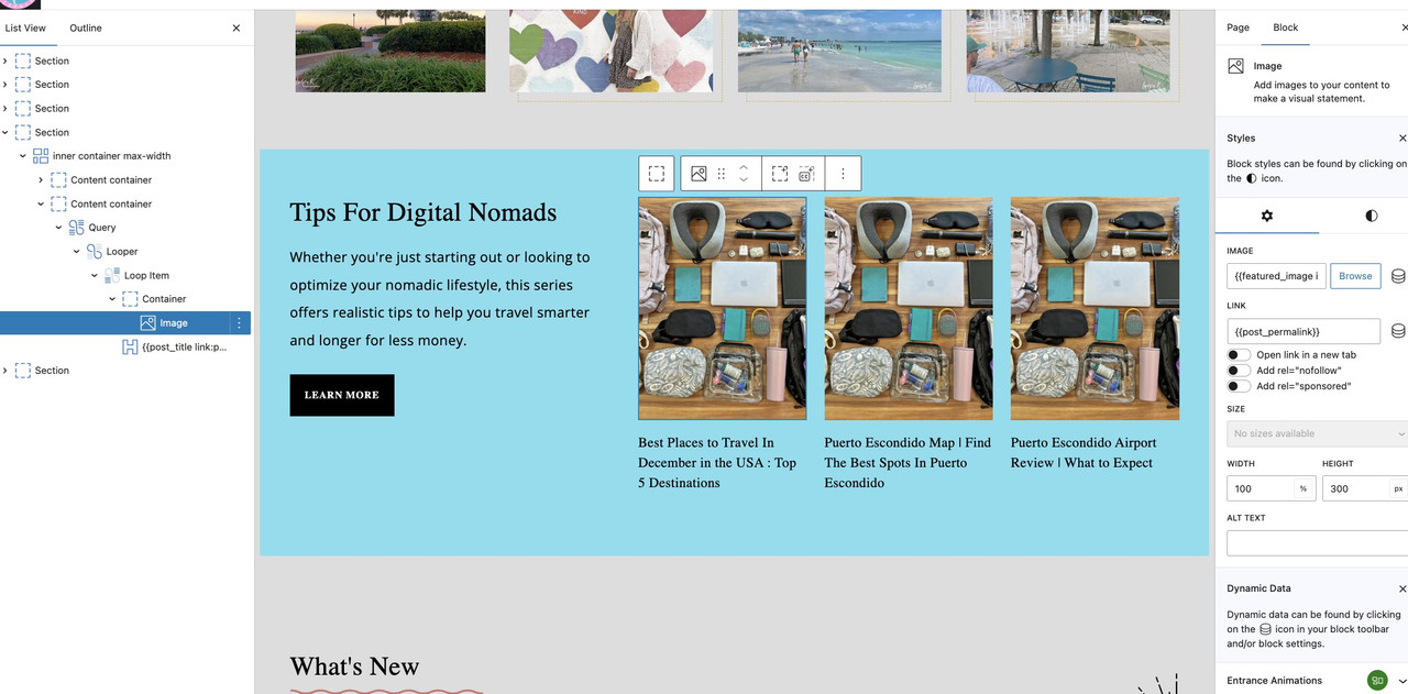

    When I try to add dynamic tags to this row of blogs on my home page, it changes all of the images in the row even when I’m only selecting one. I try creating new dynamic tags for each of the three and it always changes all 3. Can you please advise? Hopefully this will help me understand the Generate Blocks plugin overall as well.
    inspiredbackpacker.com and the section that says “Tips For Digital Nomads”
    https://i.postimg.cc/tJYHCt0S/Screenshot-2026-04-02-at-5-52-10-PM.jpg
    The image you’re trying to change is inside a Query block, so that behavior is expected.
    The correct way to update it is to change the featured image of the post itself. The image being output in the Query Loop is coming from the Featured Image dynamic tag, which automatically pulls the featured image from the current post in the loop.
