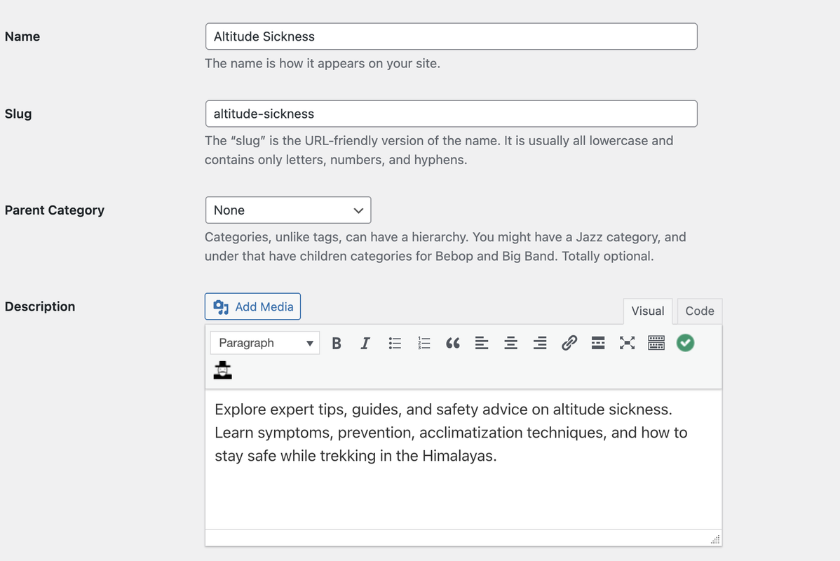

Hi, i got surprised to see the output of a simple dynamic archive description, which does not look clean.
Here is what i added : https://i.postimg.cc/d1ZM4nsQ/Screenshot-2025-11-18-at-7-07-34-PM.png

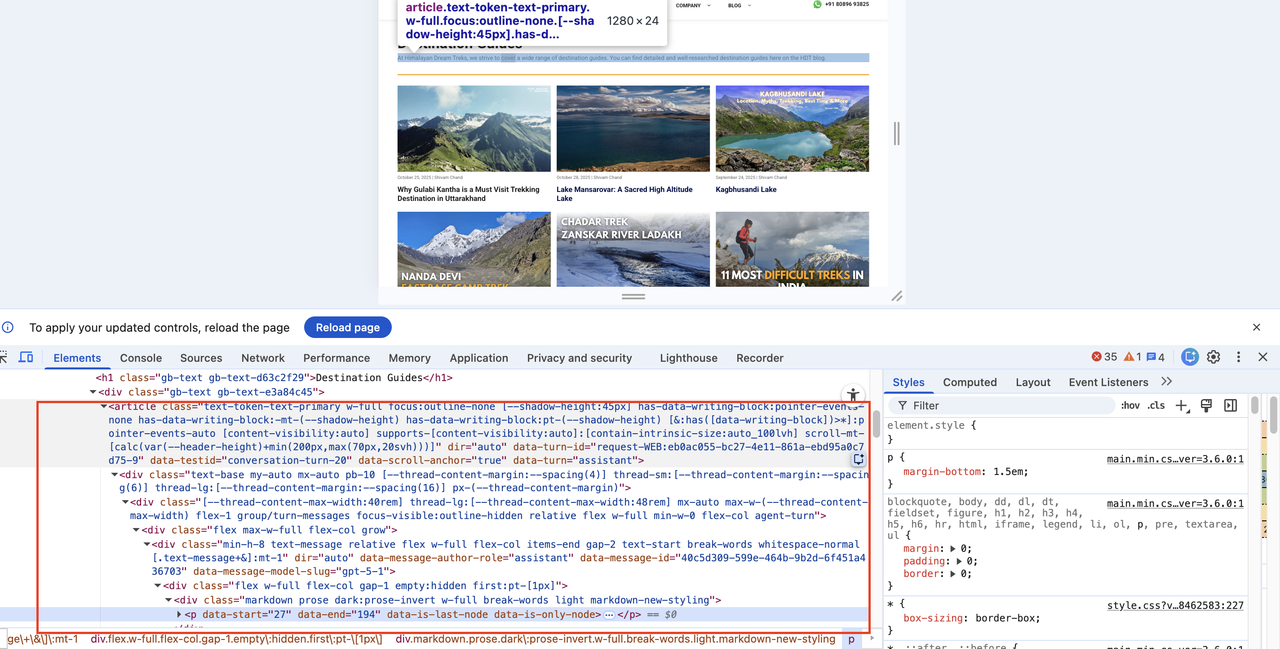

And here is the messy output: https://i.postimg.cc/3JCsSkTy/Screenshot-2025-11-18-at-7-08-21-PM.png
Please let me know if i’m missing something..
The Archive Description dynamic tag should only pulls text from the taxonomy description field.

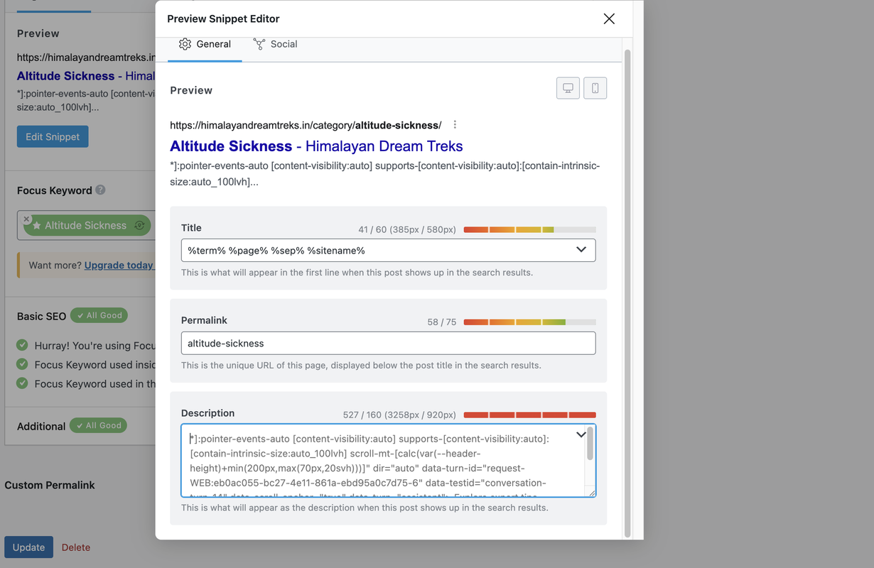

However i’m seeing at bottom have rank math seo settings and strangely seeing the same code type preview in description – https://i.postimg.cc/ZRGT3H9Q/Screenshot-2025-11-19-at-12-25-36-PM.png
vidyutdev
I found it, my client maybe created the description from AI or so and pasted and as we know WYSWYG pastes the code.
So thanks.
Is there a way to stop WYSWYG from pasting codes?
By default, the description field is just a plain text area. It looks like Rank Math is converting it into a WYSIWYG field. If that’s the case, is there an option in Rank Math to switch it back to the default textarea so it only accepts text?
