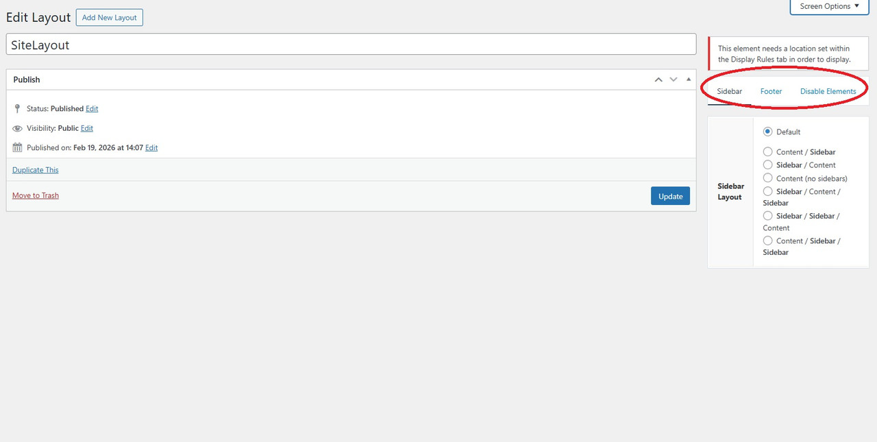

  • I did try that option for layout previously but I do not have access to all the properties you showed. Look at: https://i.postimg.cc/cCBDDYSC/Missing_Element_Options.jpg. Content and Display do not show on my screen. How do I activate those. I assume once I have these I can set width. What I had done was to set my width to 1300px in the customizer. I would prefer to have the default be this and a rule if I wanted full width per element, but I can do the way you recommended if that is best.

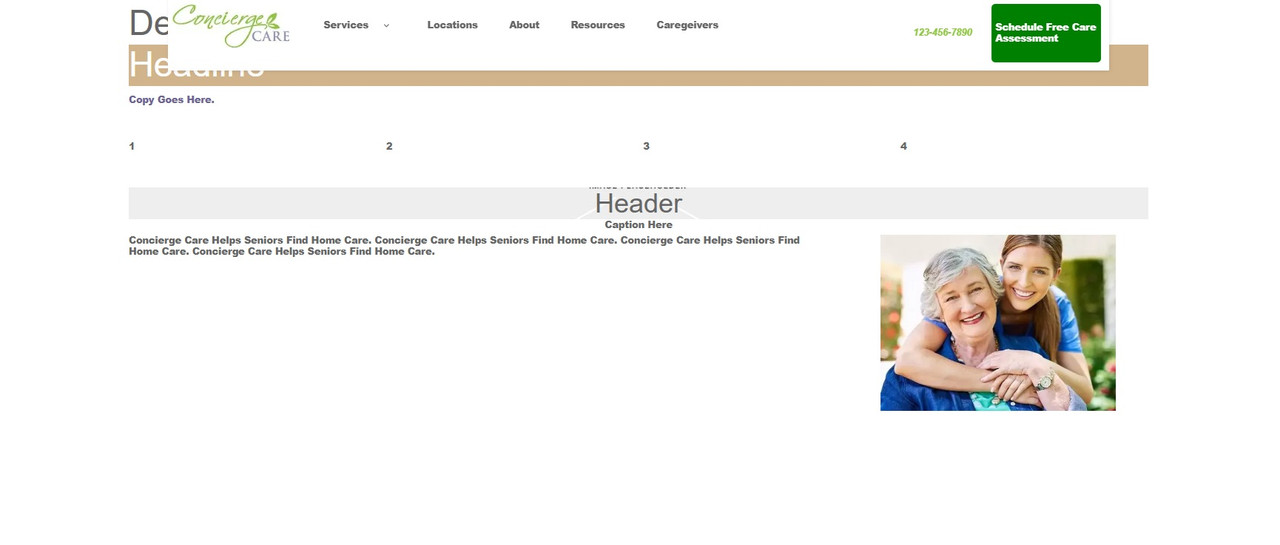

    Look at: https://i.postimg.cc/GtxMMYCB/New_Page.jpg. See how the copy scrolls under the top links but is not hidden. If we set a color on the links the site slides under correctly, but we really want a white background. How to fix this, will the layout set properly from above do this?
  • Your layout element UI has some issue, can you click the Screen option, then set the layout to 1 column to see if that helps?
    I don’t quite understand what you are trying to achieve. Can you try to explain some more? Thanks!
  • Yeah I tried that but no change. About 10 days ago when I first started these options were there. Then last w/e they disappeared. I do not remember doing anything to hide them, but must have. I even started with a new element and do not see these. What could i have set to hide these and how do I get back.
    I did try setting a container to full width but it only went up to the width of what i set in customized 1300px, so setting a design element is important.
    On the top menu I want the site copy to slide under but not be visible. I am going to try working on this.
