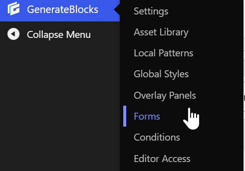

    Don’t you see GenerateBlocks Forms in the backend?
