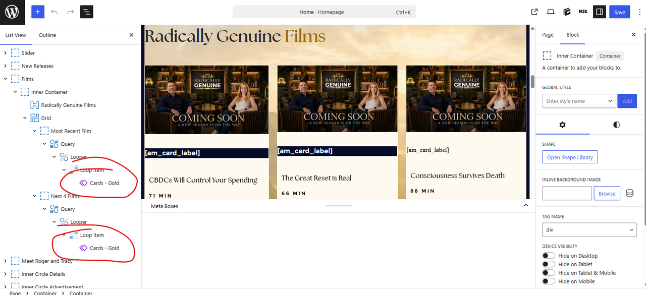

Local Pattern Has Rogue Background Color
  • I’ve been struggling to figure out why my local library has a blue background color even though I cannot find any block in the entire pattern that has its background color set to blue. It’s showing blue on the editor and in the front-end, yet no block has blue specified anywhere! Nor is there any CSS I can find the customizer that specifies a blue background color.
    Here is a link to the screenshot: https://postimg.cc/s1cy3Hwc
    The URL can be found in the private details.
    Thank you for any help!
    — Aaron

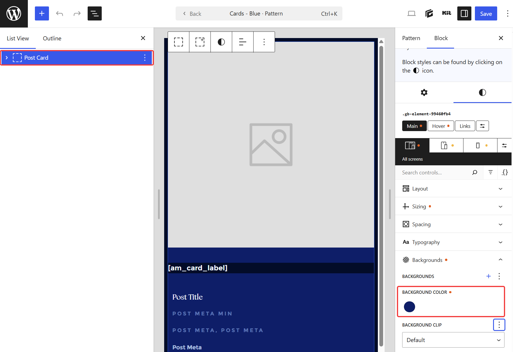

  • Are you referring to the blue background in this section?
    https://cln.sh/4S7ln4j67DLGdfpcTjZM
  • Yes.
    The .gb-element-99460fb4 container that is below the loop item container seems to have a global color of bg-cards. Have you checked this container block?

    I can see the background color being applied to the underlying pattern. You can remove that color.
    Pattern background color

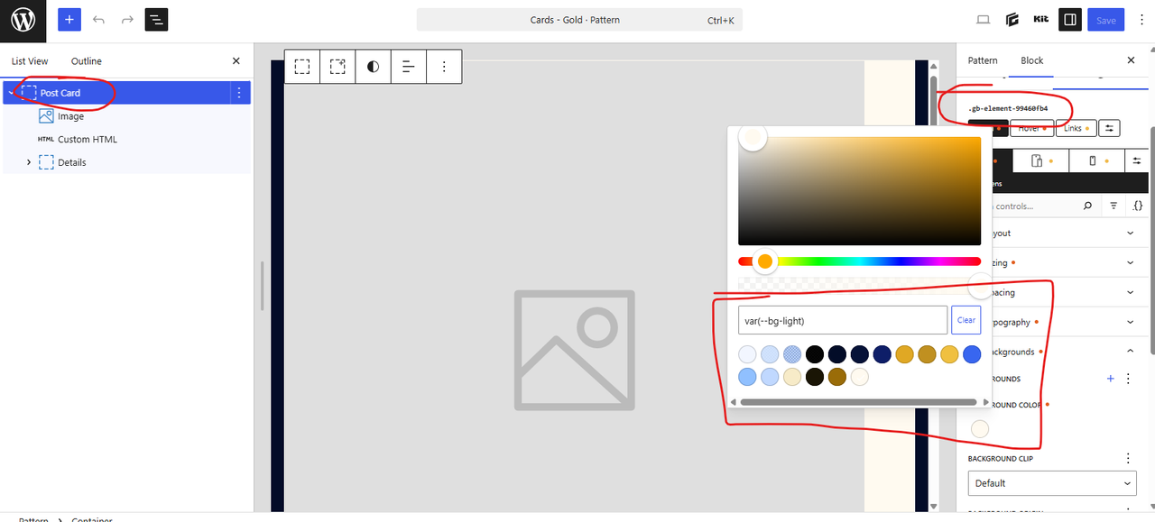

  • That screenshot is from the wrong pattern. You’re looking at the “Cards – Blue” pattern (which is supposed to be blue). The issue I’m having is with the “Cards – Gold pattern..
  • Ok, thanks for the correction.
