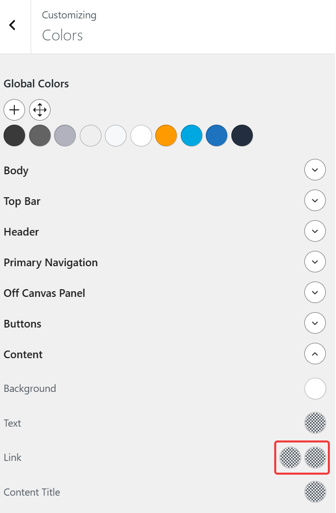

    For the link color: Try removing color values in Appearance -> Customizer -> Colors -> Content -> Links. They are usually not needed and can create issues. Body link colors are usually enough.
    Content link colors
    Let me know how it goes.
    Thanks for the prompt reply, setting the aspect ratio has solved the image shape issue, now back to square.
    There were no colour values set for Content Links in the customizer, any other thoughts?
