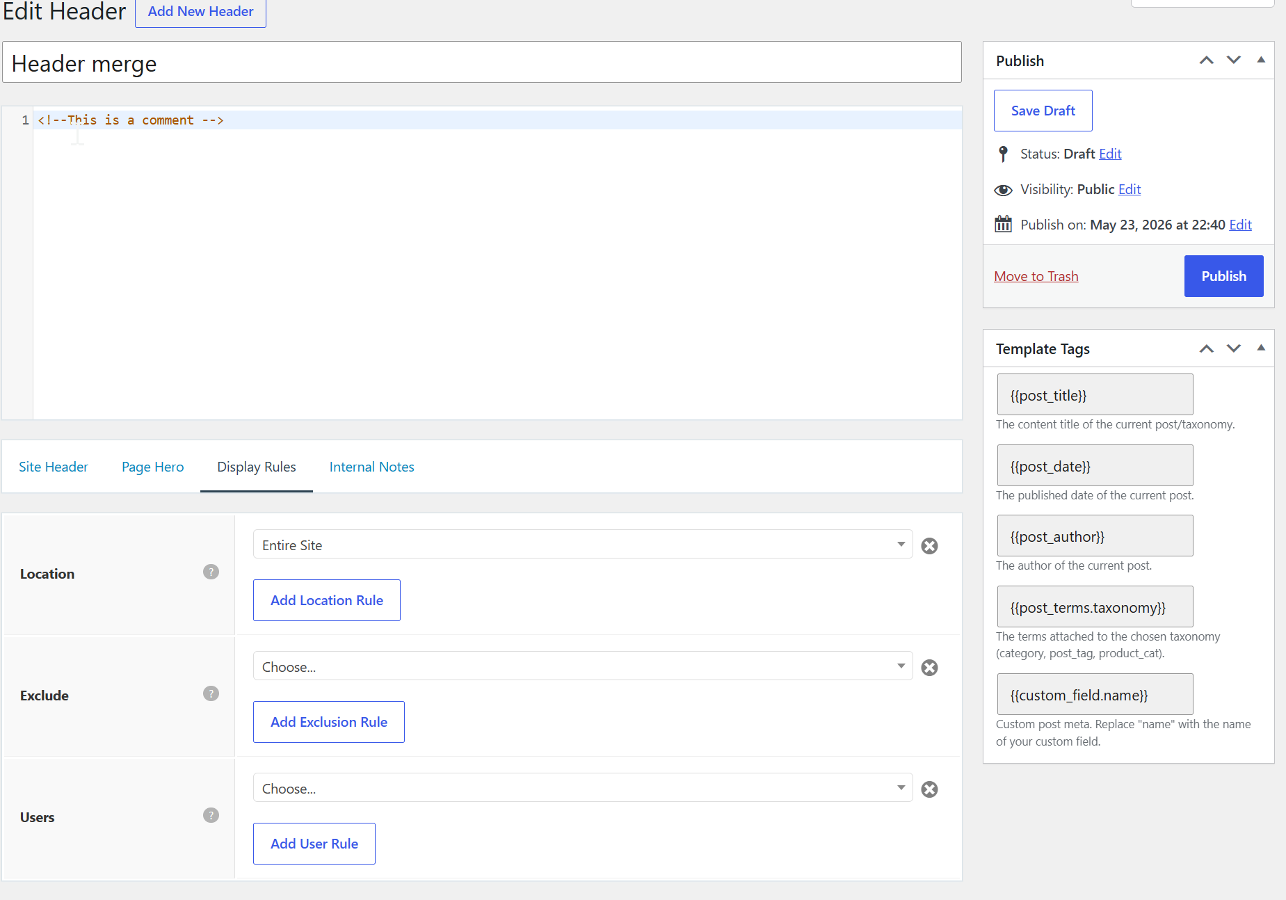

    You can add a Header element and set Merge with Content setting to Merge. Set it to appear on the Entire Site.
    Header merge
    Header merge location
