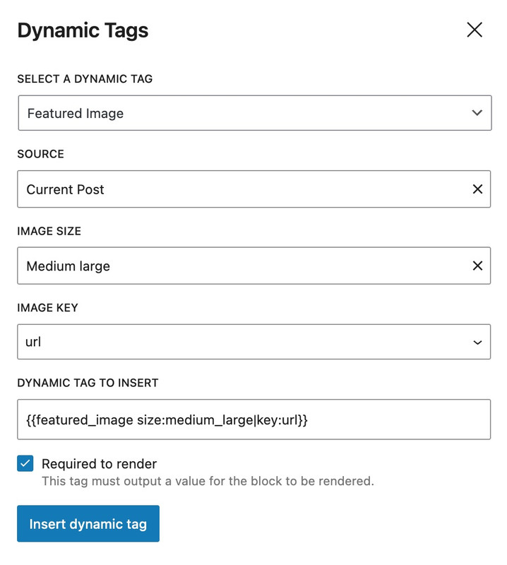

    When I edit the dynamic tag for the image, I have an option to pick the image size:
    Dynamic Tags

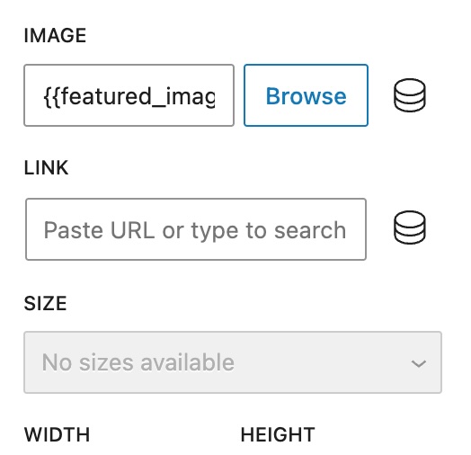

    But after I insert the dynamic tag, the image sizes are no longer available:
    Image settings
    As a result of this, the images on the frontend have the full image size, instead of the size I want to use.

    The image size in the dynamic tag settings should work.
    Can you show me the image in question on your site? What size did you choose in the dynamic tag setting?

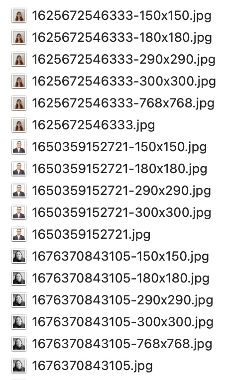

    All my images have those custom image sizes, as you can see in this screenshot:
    Images
    One thing I’ve noticed is that if you insert a GB image block outside a Query block, it won’t have any image sizes available as well, until you select an image. It needs the image to check for the sizes.
    Maybe this is a problem inside a Query block, because the images are dynamic.
    Just guessing. :/
  • thorsolutions
    I’ve done some more tests, installed WordPress and GenerateBlocks Pro in different servers and environments, and always got the same result.
    Apparently, this behaviour is normal with images inside the Query blocks. I suspect, since the images are dynamic, the Image block can’t show the image sizes dropdown.
    However, the image size I pick in the dynamic tag dialog is saved in the dynamic tag, like this:
    {{featured_image size:company-thumbnail|key:url}}
