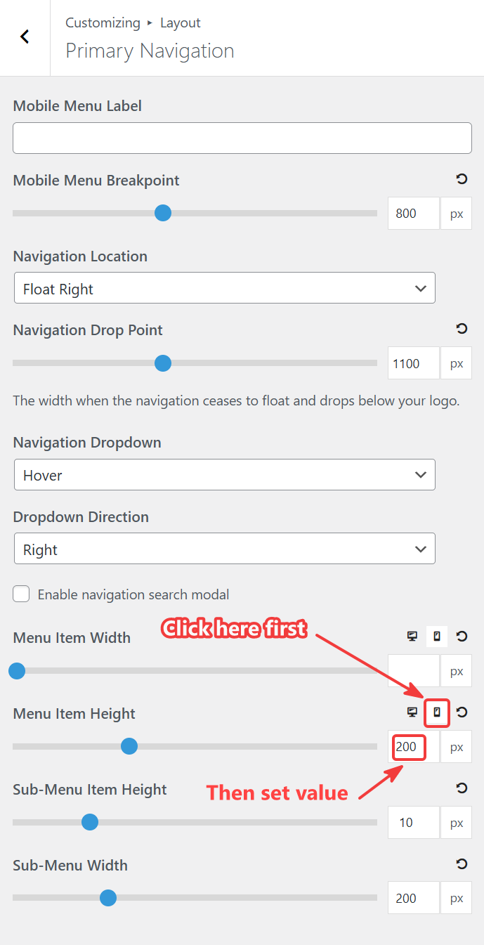

  • On the live site, go to Customize > Layout > Primary Navigation, then set the Menu Item Height value to 200px in a mobile breakpoint, matching the configuration used on the staging site.
    Currently, the mobile navigation item height is set to only 20px, which causes the menu background image to be clipped and not render visibly.
  • Done that, the Logo is back, but now the hamburger-menu is not showing.
    Apologies, there was probably some misunderstanding in the previous reply. Remove the 200px from Customize > Layout > Primary Navigation -> Mobile Menu Breakpoint (restore previous value). Instead click the mobile icon and set the 200px to the field I show you here:
    Menu item height value

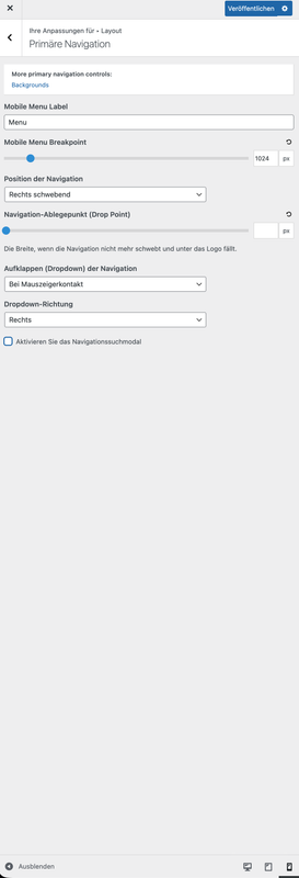

  • I don’t have these options, see screenshot (sorry for the german localisation):
    screenshot
  • Just as additional information: WordPress is 6.9.4, GP Premium 2.5.5 and GenerateBlocks 2.2.1
  • OK, I just got it… I deactivated any GP modules I’m not using… seems Spacing is responsible for this one, after activating it, the options are there and the proper design is back.
