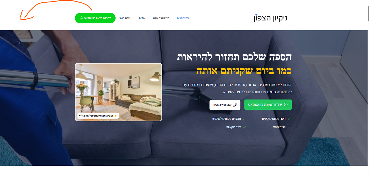

  • Hey there,
    One more questions please, in the desktop version how do I make sure the menu is centered, the logo is on the right side and the button is on the left side?
    Image:
    https://i.postimg.cc/7PnLXN16/Screenshot-2026-01-01-165906.png
    Thanks in advance!
  • Sure, try adding this CSS:
    .rtl.nav-float-left #site-navigation {
        width: 100%;
    .rtl #primary-menu {
        margin-inline: auto;
  • Worked like a charm, thanks!
