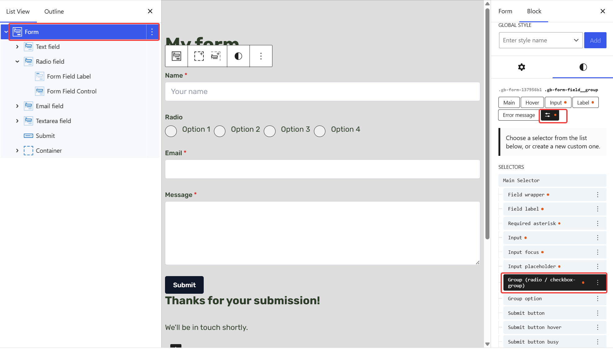

    Please, select the form block, then select the appropriate selector.
    Form radio selector
    Then, set your flex settings in there.
    Form radio field flex settings

    Thanks very much.
    That did the trick!
