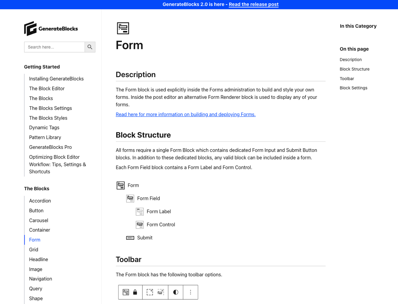

    You can find info about it on the Generatepress website.
    https://learn.generatepress.com/blocks/block/form/
  • Ah, sorry, I got it now, you are using the latest beta version of the plugins.
    Thank you for providing the testing feedback, much appreciated!
    I’ll forward your feedback to the dev team to improve the block.
