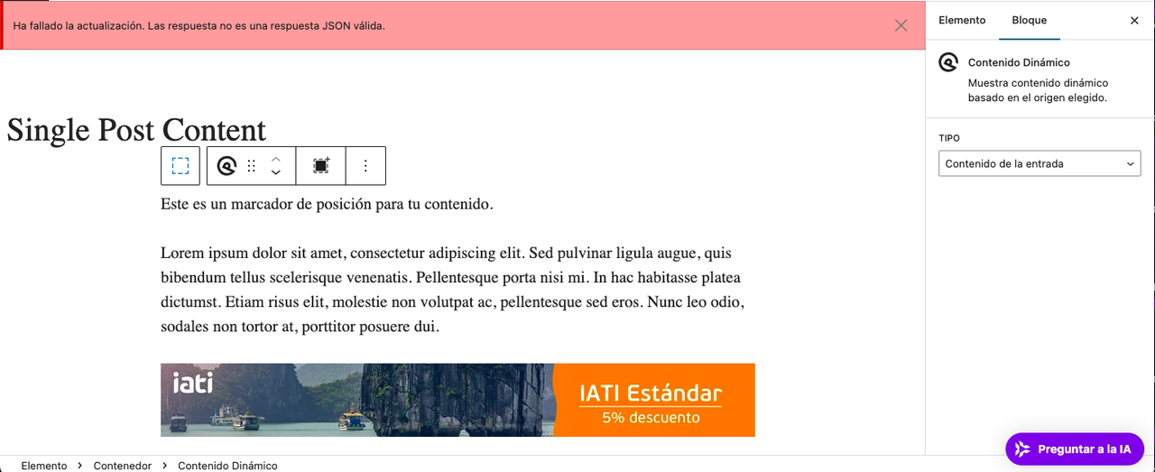

  • Hello everyone! I’m reaching out because I have an issue when trying to update, for example, the links in the footer. I get a message that says “The update failed. The response is not a valid JSON response.” This happens in any section of elements. I can’t update anything.
    I’m attaching an image.

    I’ve done what Alvind told me. It’s not working. I’ve deactivated the plugins and only kept GeneratePress and GenerateBlocks activated. Even with just those plugins active, it’s still not working, and the same error message appears. I’m worried because I need to make some modifications to single post content element and the footer. I’ve checked the .htaccess file, and everything seems fine.
    If I use the classic editor, the error doesn’t occur; it’s with the block editor that the error appears. I tested it on the TOP BAR. Now the social media icons are not showing.
