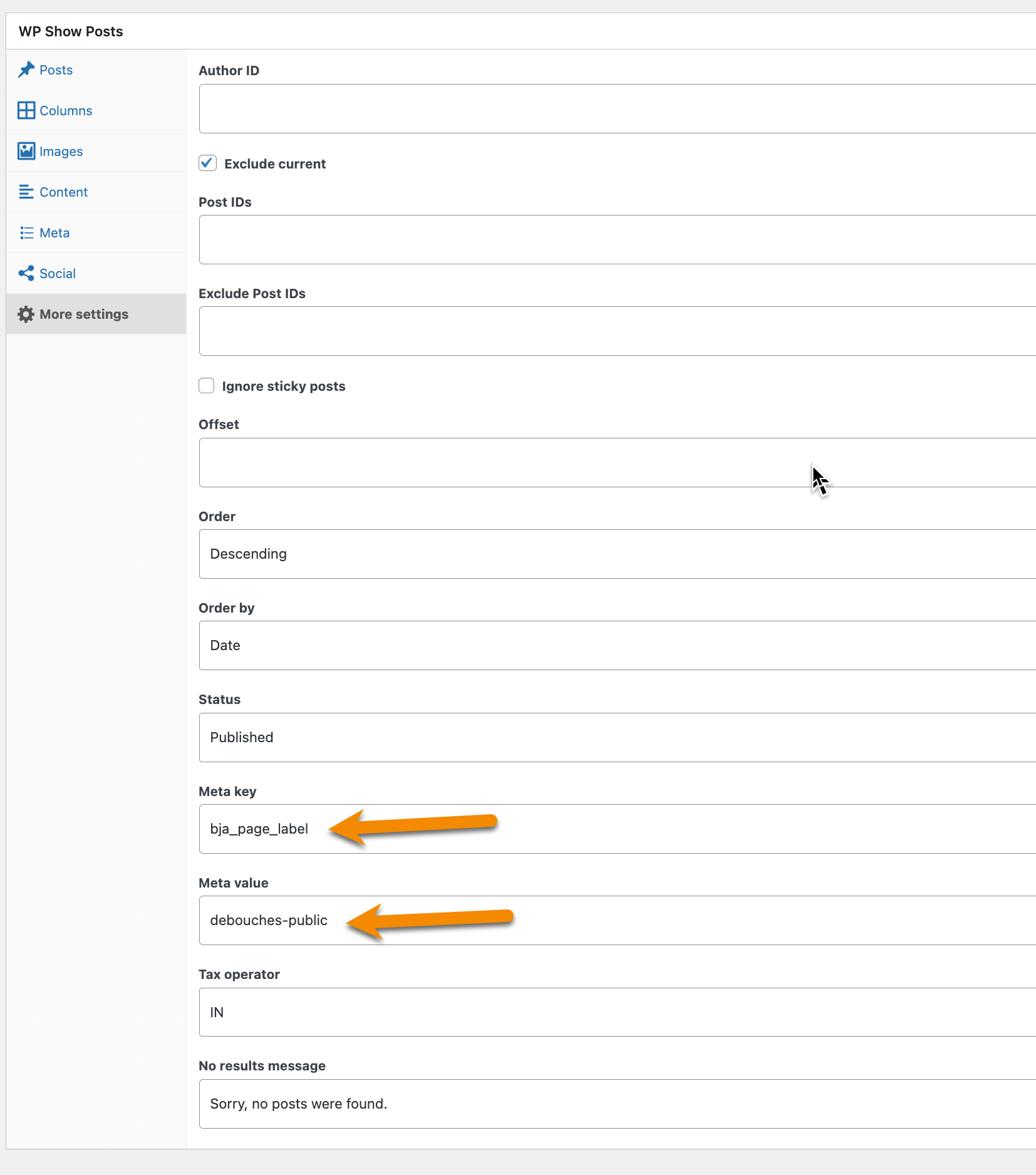

    I was using WP Show Posts Pro to create custom PAGE lists based on a page meta_key / meta_value filter.
    How can I do this with generateblocks Query Loop?

  • Hello Ying,
    Unfortunately that’s a major drawback compared to WP Show Posts:
    I have like 10 “lists” that would need different CSS classes and code snippets. Pretty close to un-usable when in WP Show Post it was just a matter of configuring the meta_key and meta_value like this:
    WP Show Posts Loop Filter on meta_key and meta_value
    I can’t seem to be able to quote Tom @tom but this should have been migrated into the Query Loop in a user friendly manner.
