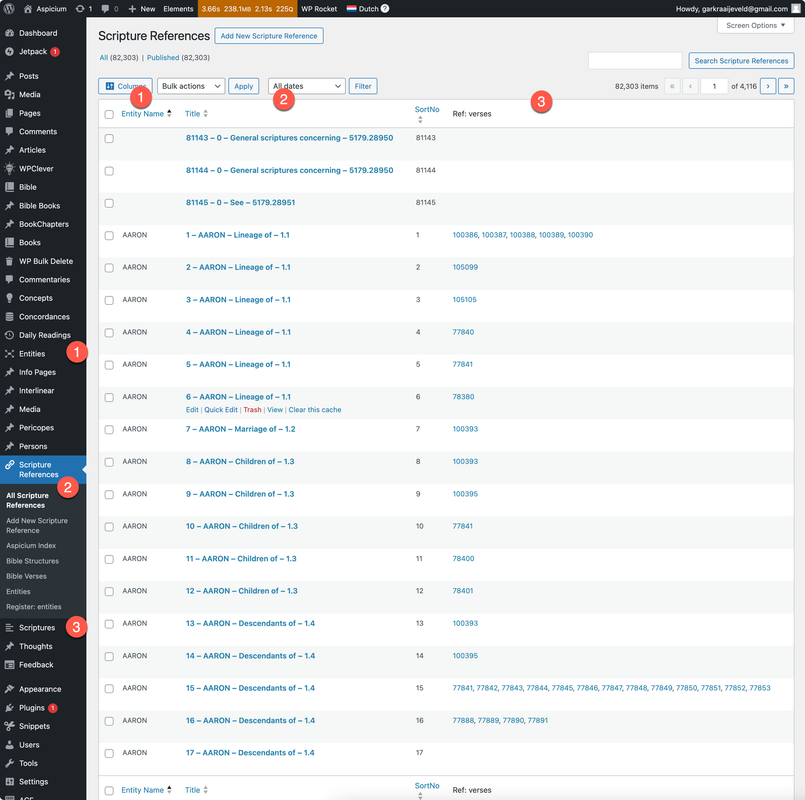

  • Yes, the image below shows how it’s setup:
    2024-09-27-13-01-48
    If it works better with relational fields that can be done too. But I have the idea that having many ACF relation fields makes the site slow.
