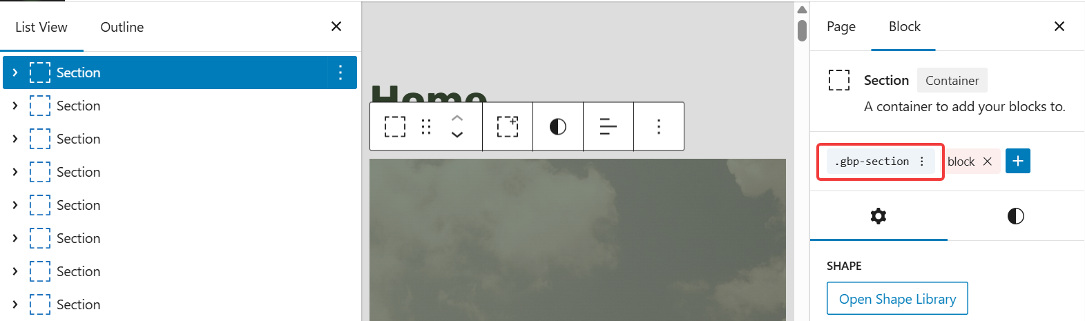

    Each of the sections have a .gbp-section global style with the following value.
    padding: 5.25rem 40px
    You can remove that global style or edit it accordingly.
    Section global style
