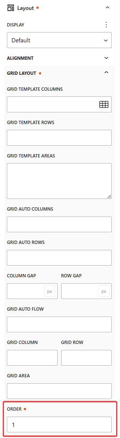

  • Hello. Three things:
    1. On mobile, let the grid’s DISPLAY value to Default. This will allow the container to keep displaying as a grid on mobile, too.
    2. On mobile, set the grid’s GRID TEMPLATE COLUMNS value to 1fr.
    1fr grid template columns value
    3. On mobile, set the third grid container (the second image) to have an ORDER value of 1.
    Change grid container ORDER value

  • Ok, I see, those blocks are set as flex and have display property set as Block for tablet. Set Display to Flex for the second pattern on mobile, and FLEX DIRECTION to Column. Then, set ORDER to 1 for the first container (Text).
    Thanks, you pushed me in the right direction.
    In my case, setting Display to flex and Flex Direction to column reverse was enough.
    Setting order was not needed at all.
    Thanks a lot!
