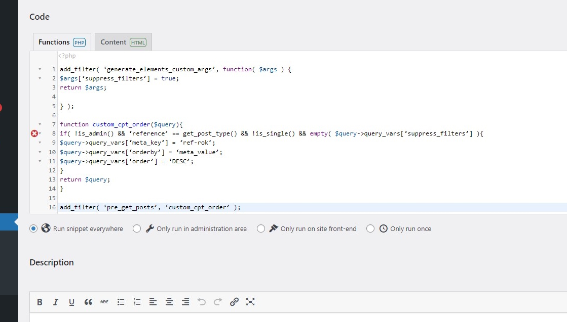

  • Hi Fernando! I put the code you gave me, but it warns me of a syntax error in line 8. Can you see it?

    add_filter( ‘generate_elements_custom_args’, function( $args ) {
    $args[‘suppress_filters’] = true;
    return $args;
    function custom_cpt_order($query){
    if( !is_admin() && ‘reference’ == get_post_type() && !is_single() && empty( $query->query_vars[‘suppress_filters’] ){
    $query->query_vars[‘meta_key’] = ‘ref-rok’;
    $query->query_vars[‘orderby’] = ‘meta_value’;
    $query->query_vars[‘order’] = ‘DESC’;
    return $query;
    add_filter( ‘pre_get_posts’, ‘custom_cpt_order’ );
    Thanks,
    Daniele
  • Replace all the curly quotation marks with straight quotation marks.

  • Try this instead:
    add_filter( 'generate_elements_custom_args', function( $args ) {
    $args['suppress_filters'] = true;
    return $args;
    if( !is_admin() && 'reference' == get_post_type() && !is_single() && empty( $query->query_vars['suppress_filters']) ){
    $query->query_vars['meta_key'] = 'ref-rok';
    $query->query_vars['orderby'] = 'meta_value';
    $query->query_vars['order'] = 'DESC';
    return $query;
    I corrected the syntax error.

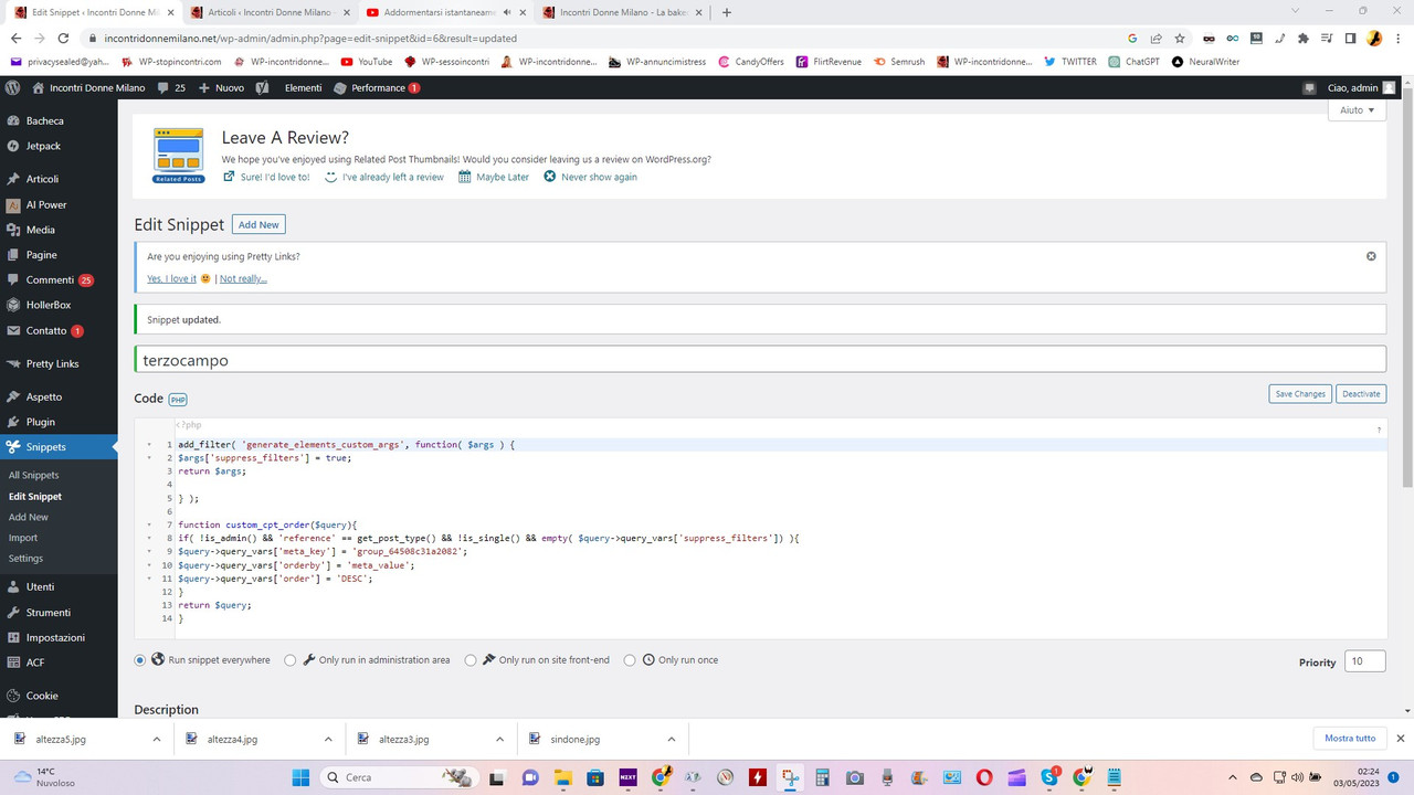

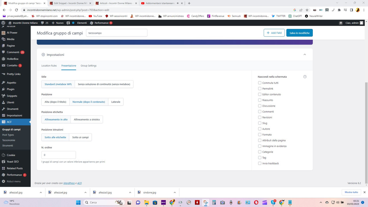

  • Hi Fernando! Many thanks, now the script has no more errors! However, after doing all the work, no posts are displayed any higher. Nothing happened at all! What am I doing wrong?
    Below, I show you what I did on a test site:
    https://i.postimg.cc/gJ5snV3f/01.jpg
    https://i.postimg.cc/8c6HW7Hs/02.jpg
    https://i.postimg.cc/dQkngfYv/03.jpg
    https://i.postimg.cc/nVyTx1Fm/04.jpg
    Thank you, you’re so kind!
  • Use the “Field Name” not that Key as the meta_key.
