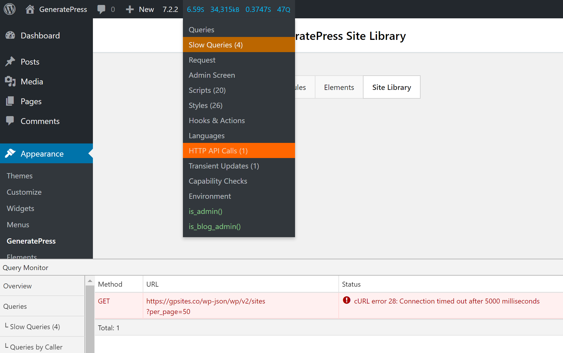

    If it still doesn’t, please install the Query Monitor plugin. Once installed and activated, head back to “Appearance > GeneratePress > Site Library” and click the Refresh Sites button again.
    In your admin bar, hover the Query Monitor area and click the HTTP API Calls link, as the screenshot shows.
    The most common error is shown above: cURL error 28
    This typically means your server isn’t able to communicate with https://sites.generatepress.com/ (where the API for our Site Library lives).
    You can check with your hosting support, as they will be able to tell why the error is happening.
    If there isn’t a block in place, it’s possible that ModSecurity is enabled on your server. Ask your hosting to disable it while you use the Site Library. It can be turned back on once you’re done using the importer.
