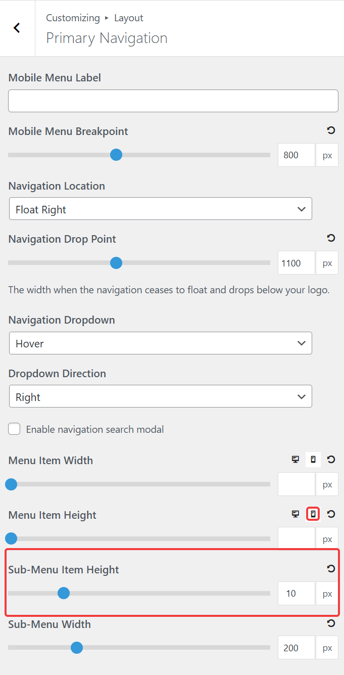

    Customizer -> Layout -> Primary Navigation, click the mobile icon and adjust Sub-Menu Item Height value.
    Adjust mobile sub-menu item height

    When I change this setting, it also changes it on the desktop view as well which I don’t want to do. Is there a way to change the height of the sub menu on mobile without it also changing on desktop view?
    Selecting the mobile view will only change the sub-menu height on mobile. What is that value set on desktop view? If you click the desktop icon next to the icon I highlighted in my previous screenshot, you should be able to modify the desktop value.
  • Emma Schwartz
    When I change the setting in mobile view it also changes on desktop. It doesn’t seem to allow me to set a different value for mobile view. It is currently set to 7px which looks fine on desktop.
