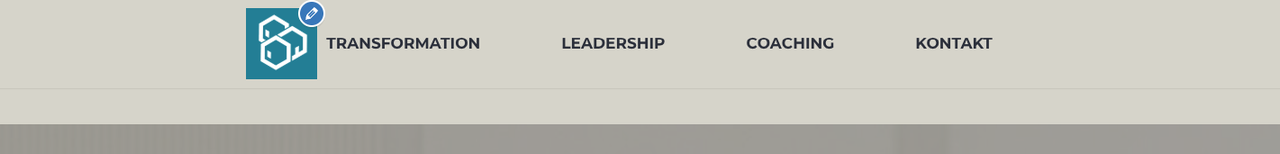

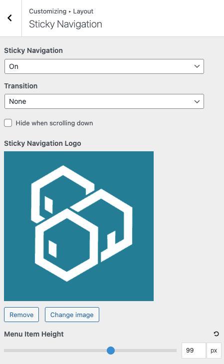

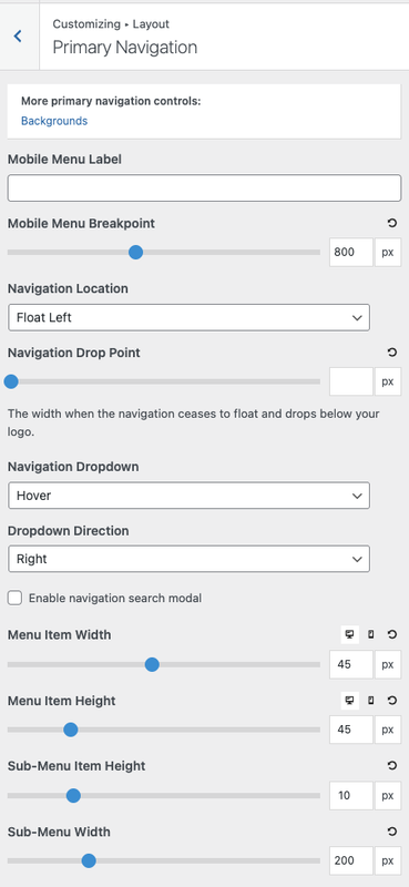

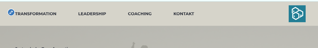

    For the primary nav I have set the Navigation Location to “Float left”, however the sticky nav does not inherit this setting, and also the max width is different (check screenshots). I haven’t applied any custom CSS, using GP + GB latest versions.
    Primary Nav Settings

    Sticky Nav Settings
    Sticky Nav view
    How can I ensure the sticky nav matches the primary nav?

  • Try this CSS:
    .inside-navigation.grid-container {
        flex-direction: row-reverse;
        justify-content: space-between;
    body .inside-navigation .navigation-branding {
        margin-right: 0;
    And you can control the navigation height by menu item height at customizer > layout > primary navigation.
